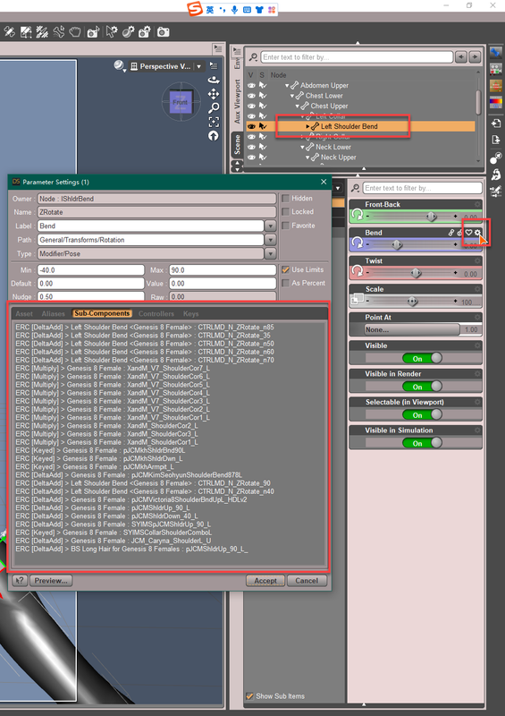

    It seems there's a ERC Freeze with Left Eye Side-Side... you may go to Bend dial while selecting the joint 'Left Shoulder Bend', click that Gear icon on Bend, go to Sub-Components tab, check if there is ERC relates to Left Eye...
