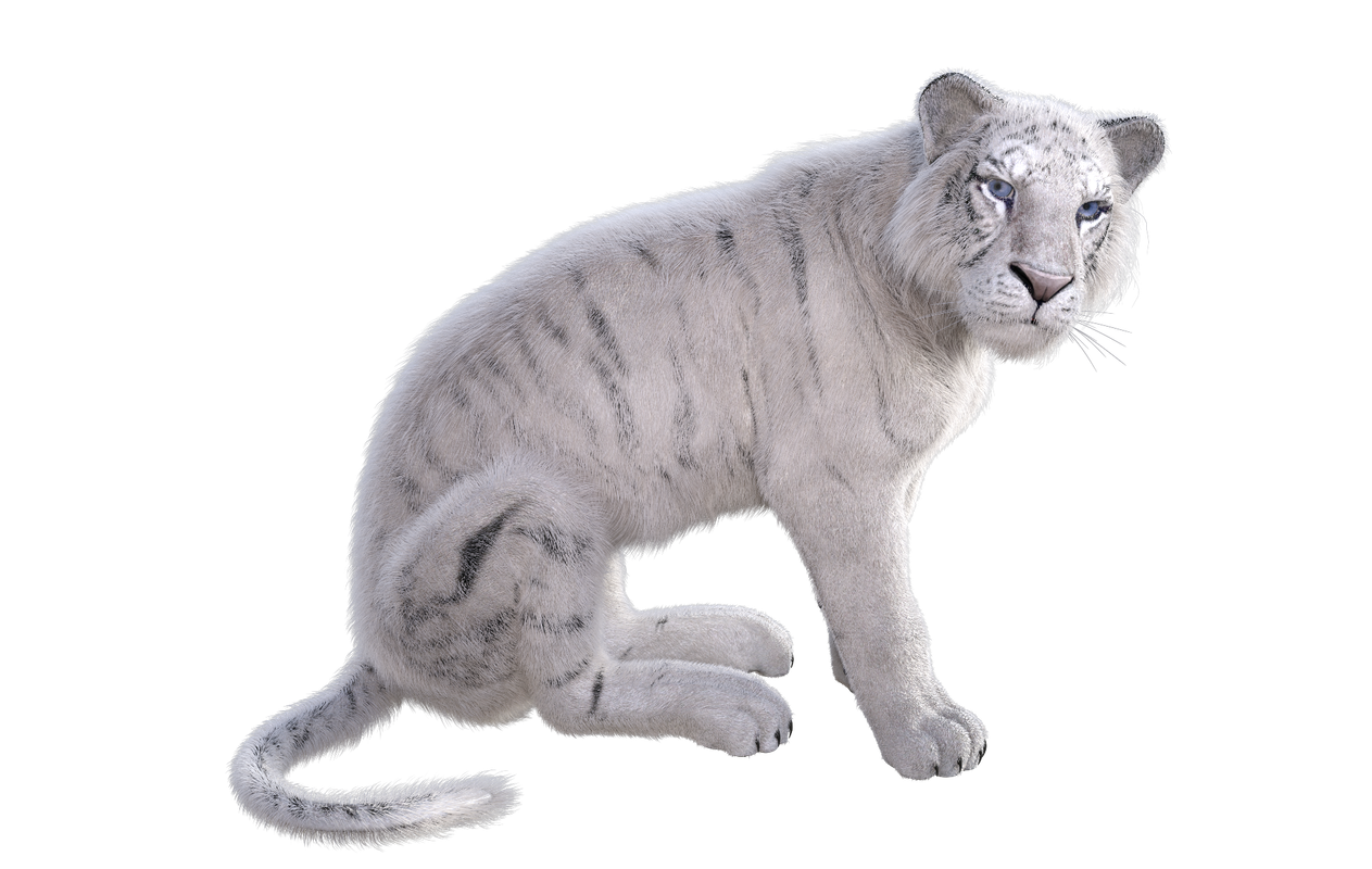

  • If it helps, here is a render I ran that demonstrates both issues. That right eye (left side of image) keeps the washed out texture and much smaller pupil no matter what I do. And the Catalyzer pane has all the color options set to white (255/255/255).

    Thank you, sir! I also got a response from the artist and, between copying some textures between folders and adding an HDRI/set, I got this working properly. Really appreciate the advice.

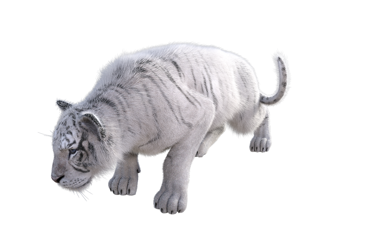

    I'm having this same problem (see test render below) where the white tiger's fur strands render out dark (gray-blue). I'm using the LAMH 2 Iray Catalyzer add-on with default settings to render. I tried changing some of the Iray Catalyzer settings, but nothing is helping to get the look of the promos or some of the gallery entries with the white tiger. (Changing diffuse settings for example gets me more of a big white furred cat with the stripes hidden, so not sure...)
    I'm not sure what textures I should to look for or move around to get this going. If croll or anyone else knows what can solve this issue, I'd really appreciate it!

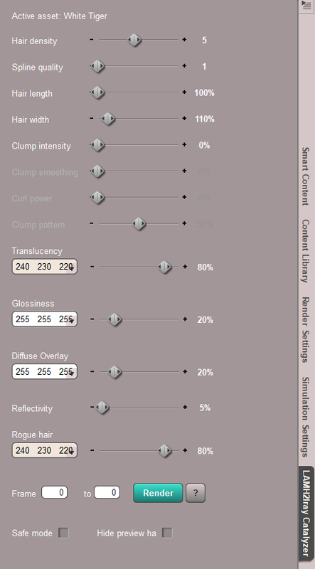

    Yes... so if you use Catalyzer plugin, pls try the settings as below:
    The render results as below -: (you may finetune the values as you wish, as well as the lightings...)
    crosswind Thank you so so much for sharing these settings for the Catalyzer add-on. heart I'll give it a go and tweak to suit. yes
    I do wonder if using the Catalyzer version limits how the fur renders, as opposed to using the LAMH version. It still seems different from how naturally the fur sits in the promos and how it follows the stripes. Some of the gallery entries also have that look. I wonder if those used the original LAMH version...

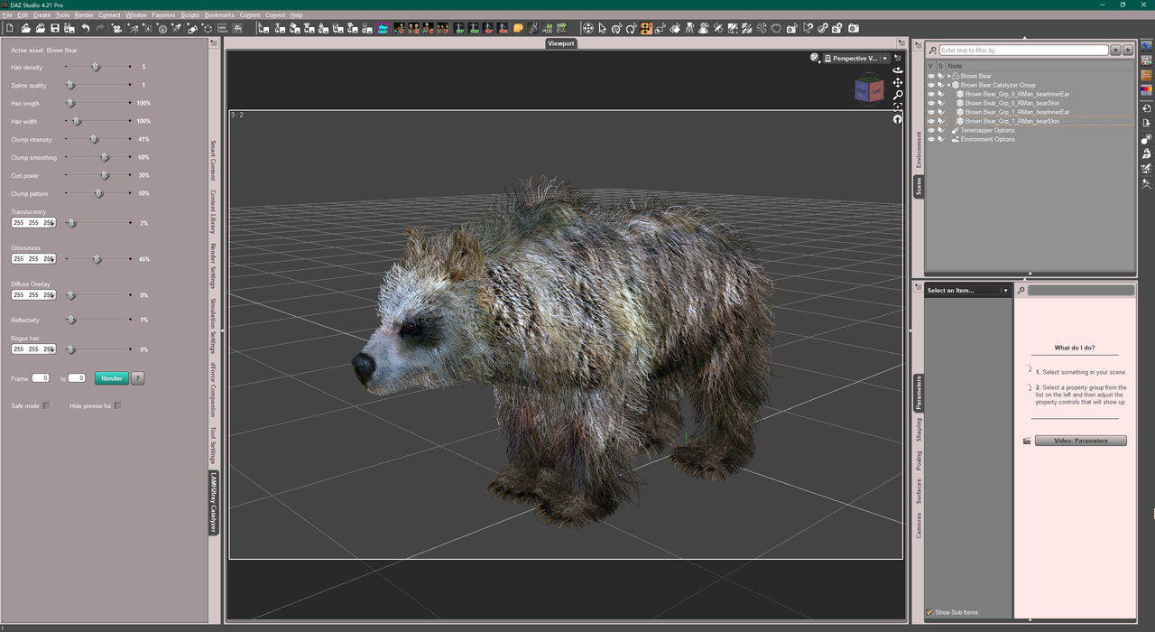

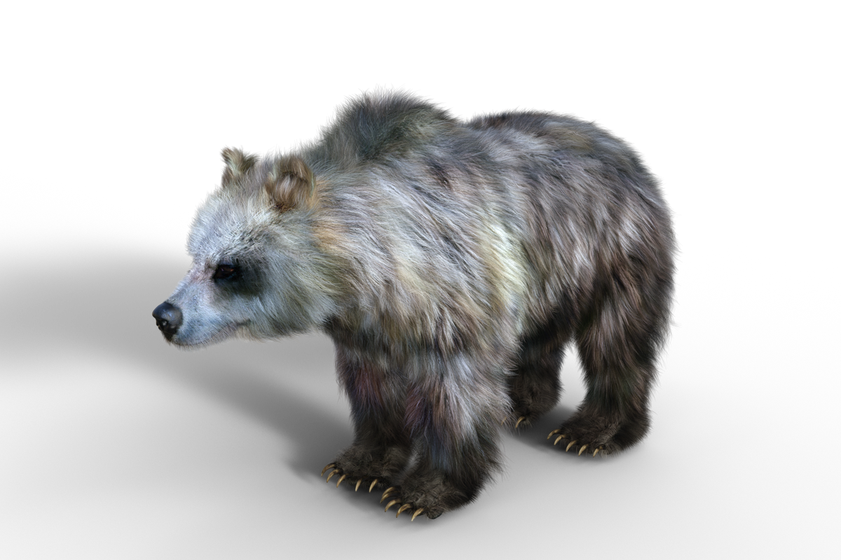

    You're welcome! And Yes... I also found LAMH version of this tiger was much better than Catyalyzer version at that time... but TBH, I don't know why because as a user I have no way to make those 'catalyzer fur group' for testing...
    In comparison to Brown Bear from AM (released one year later than Catalyzer version of White Tiger),  the fur group looks totally different and the render is also great just with the default settings of Catalyzer... So I could only presume it was the product problem of Catalyzer version of White Tiger ...
