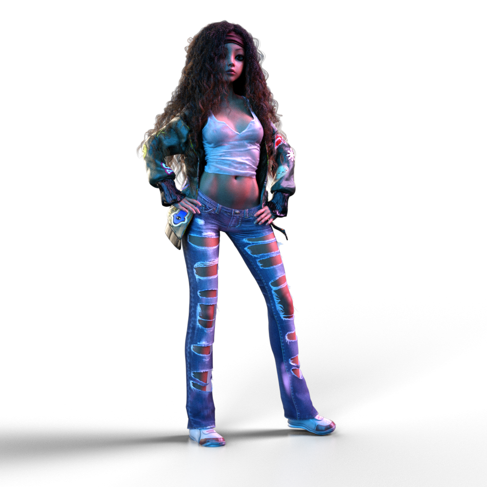

    Those of you who have my Dynamic Character Animation in Daz Studio Course will know about the 30 frame buffer zone I use for All of my character animations.
    Using the image above as an example (click for larger) the first simulation I performed was the Tank Top shirt (Linday's Car Wash Girls), in which I only ran dForce through frame 20 or so to tighten the damp shirt to her.
    The pants (smay's Torn Clothes) are next. If they blow up because the legs get too close to each other, I use "Legs Spread" as a temporary pose on the legs to get through the simulation, then selct the Legs Spread key frame and get rid of them. That's something I really love about dForce - we can do things like that and the rigging will work with the simulated cloth as long as we don't overdo it.
    Then comes the jacket, which is actually hanging off her shoulders. dForce Rebel Yell (Joe Quick) is awesome! For a rather fast motion that she was doing, it took a bit of practice and test renders to get the behavior that looked best, and each time was fun! :)
    The jeans had to come first because the jacket has to collide with them. The shirt is kept from simulation visibility unless a need arises otherwise - which is very rare.
    The Classic Long and Curly Hair with dForce (Linday) was last, as it needs to collide against the jacket.
    Now, for this example with an unfinished WIP of Rosie 9, I worked Compression and Expansion in the dForce surface materials of each layer of hair - making the back longer and bigger and some of the upper layers more constricted to introduce more curl and a bit of messy. Worked great!
    Additionally, I'll change (for example) the sleeves of the jacket's dForce surface material to have higher friction so the hair likes to stick to it a bit more than default. It seems very common for many folks - especially folks having issues with things blowing up, to go the other way and reduce the friction value to its lowest state. I like using friction and experimenting with different values to really get interesting with my simulations - and it's been working really well to my eye.

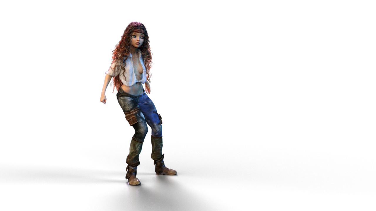

    Believe it or not, this shirt is actually from 3D Universe's Willow for Genesis 3 Female
    I added Fit Control and had to do some clever mesh work to get it working in dForce.
    Sixus 1's Evade finishes out the costume.
    The final wearable preset is a wonderful 'load n' go' dForce experience, as are most of my dForce custom wearables.
    ...and this time Rosie's sporting the newer Linday Wet Style Curly Hair with dForce, which is yet another Home Run by Linday! I've been having such a great time with every Linday I buy, I've taken it upon myself to start collecting the entire store. In the recent sale event and Flash Sales, I've got a pretty decent haul going!!!
    I really like Rosie 7!
