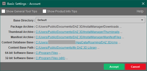

    Hmm, might be a good way... I just used DC for less than a week years ago and never used it again but just Install Manager in which there's a 'Default' option under Base Directory. The default setting should be all the same in DC.. You may give it a check.

    This UI is from Install Manager but not DC, I just wanna show you the 'Default paths' of Base Directory...

    Hey. Just wanted to let you know that by installing the "Install Manager" from Daz, I was able to figure out the asset installation path which led me to be able to fix my problem. Thank you so much. I always thought that DazCentral was just a modern version of Install Manager, but it appears Install Manager has a few features not available on Daz Central. Thanks again :)
