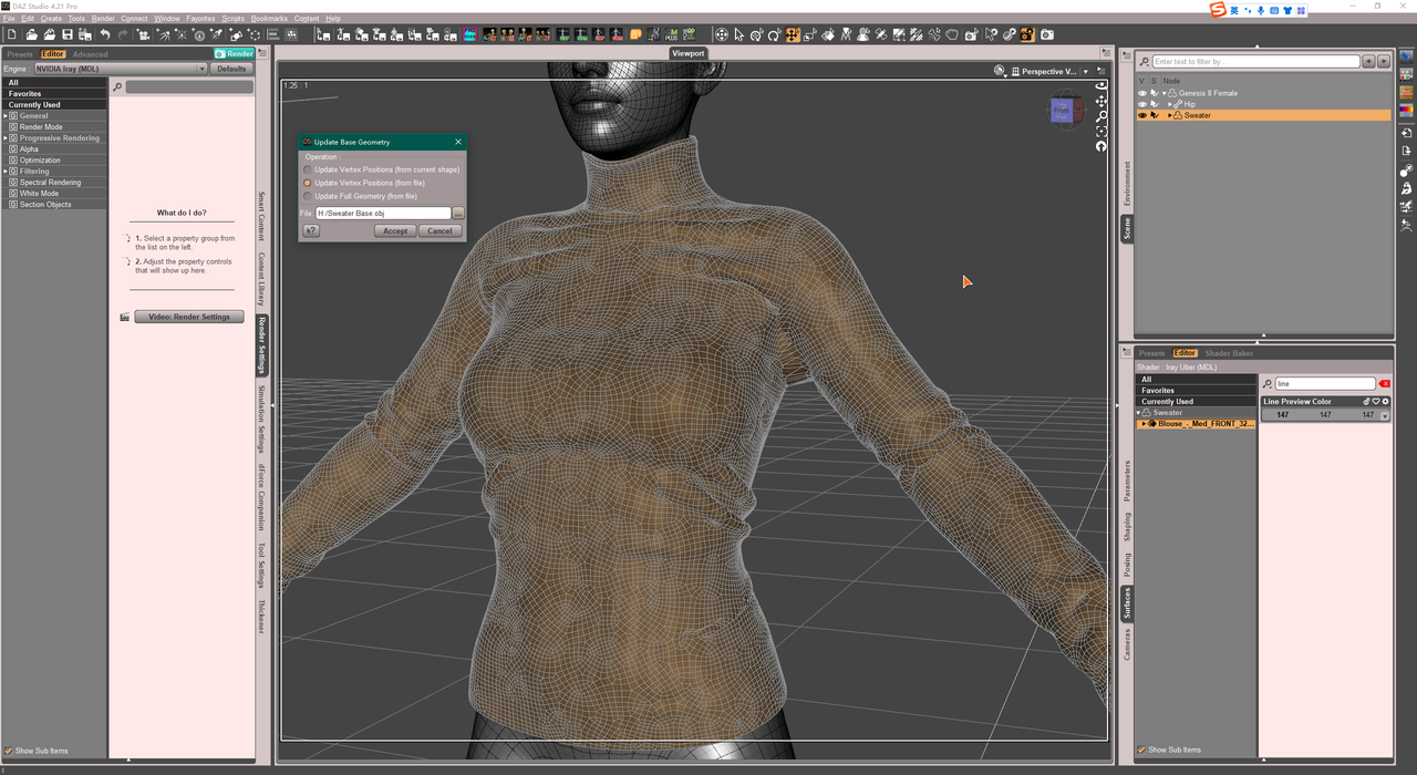

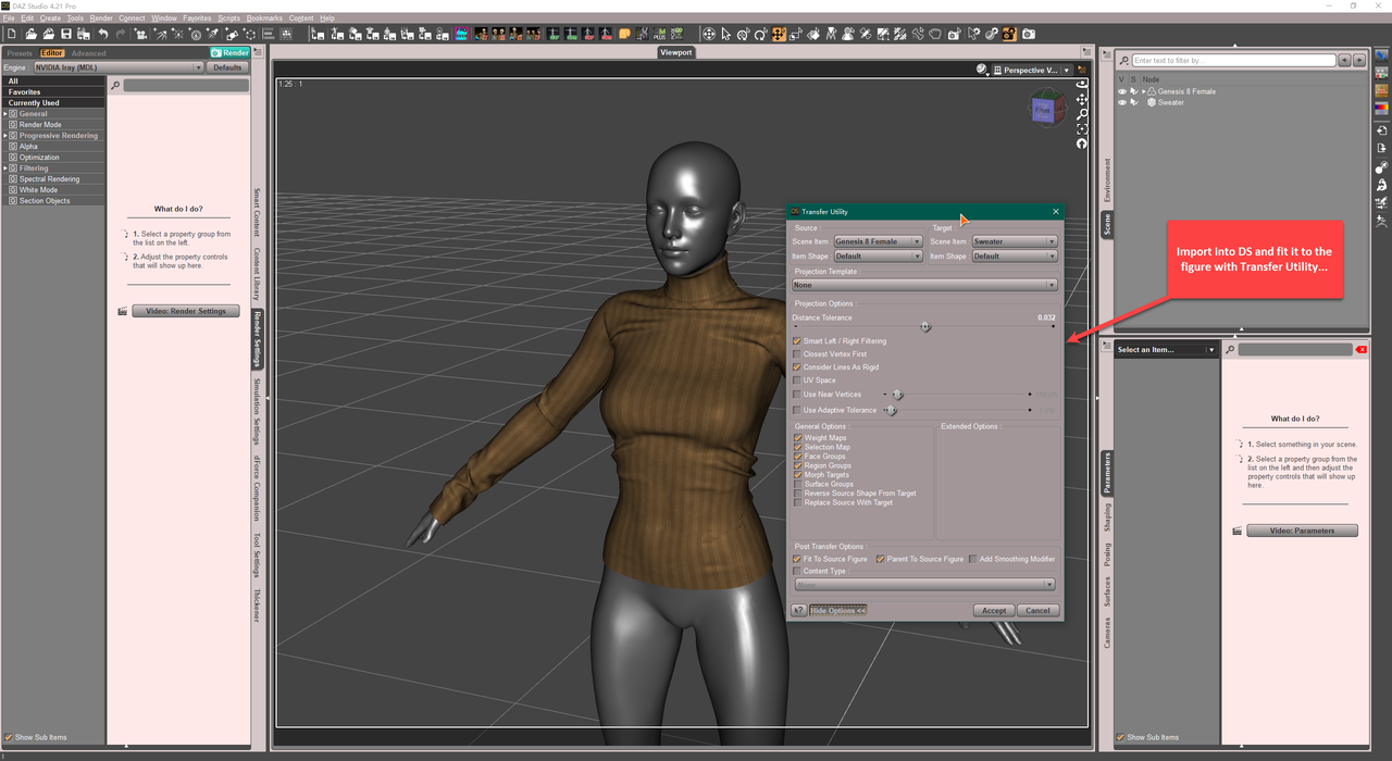

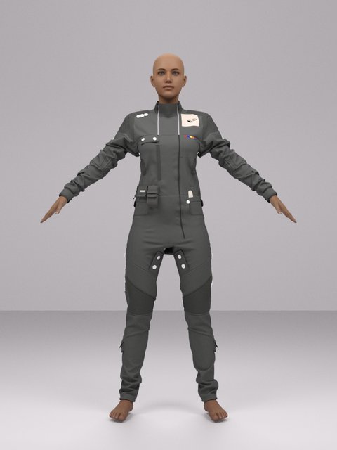

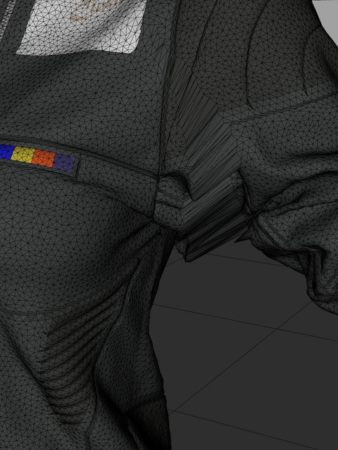

I am trying to rig a jumpsuit that I bought on ArtStation for Genesis 8 Female. The clothing was created in Marvelous Designer using an Genesis 8 avatar that was not in the default A pose (arms and legs were not spread apart enough).
Non-default pose
As a result, Daz's transfer utility is mapping vertex weights in the armpits and crotch regions to the wrong bones.
Default pose
When the arms are moved from the torso, the vertices in the armpit sections are sticking to the chest region.
Viewport Render
I have tried redistributing the vertex weights in the affected area(s) to the correct bones with no success. I have also tried manually assigning the responsible vertices to the arm with less than optimal results.
From other models that I bought, I think that this seems to be a frequent problem with ArtStation models where the avatars are a non-standard shape or pose. From what I have read online, artists frequently deal with this using morphs and/or manual weight mapping but I can't seem to figure out how to do that for the jumpsuit.  I am hoping that there is a native solution in Daz to correct and fine-tune weight mapping misalignments.
Any advice, assistance or references (e.g. tutorials) on how I can correct these types of issues for clothing with complex geometry would be greatly appreciated.
Thanks!

    also was the pictures posted in OP after selecting the 'reverse source shape from target', or whatever the option is called, when doing transfer utility?
  • arstropicaarstropica Posts: 49
    lilweep, Thx.
    I rigged the suit using that reverse option.  For whatever reason, the suit does not retain its basic shape when simulated in marvelous designer with a correctly posed avatar. But TBH, having just gotten MD, I am not very knowledgeable with that software so I am not sure if this is due to a flaw in the clothing design, or if it's something else.
    I believe that my best bet is to fix it in Daz and/or use Blender to do post work. It's part of a project for my personal use and my own edification.

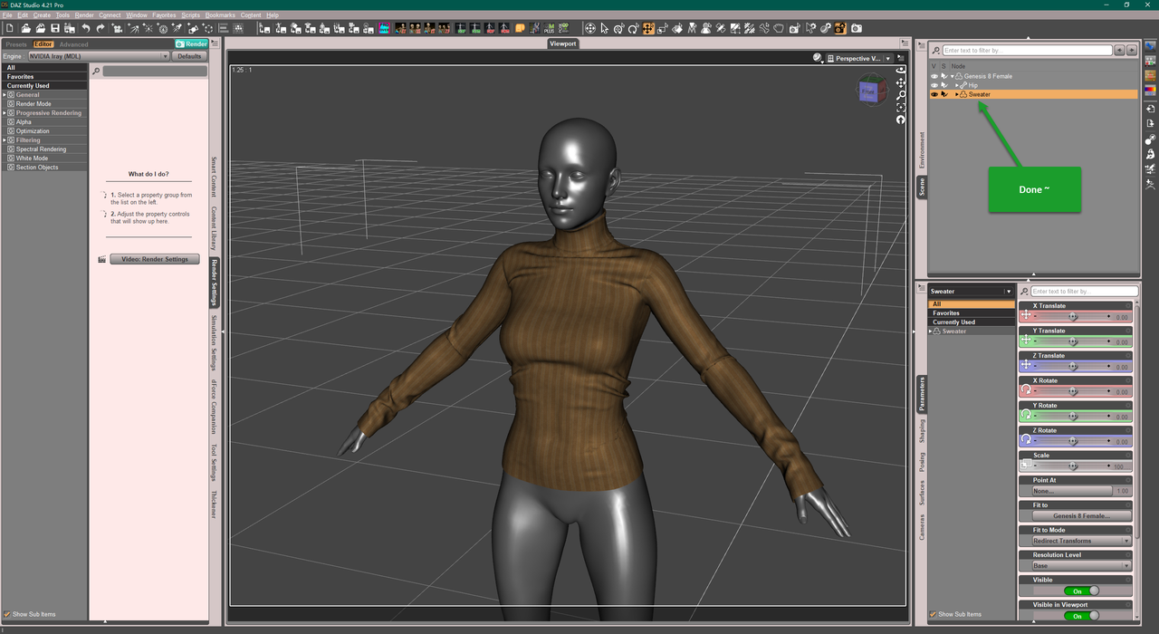

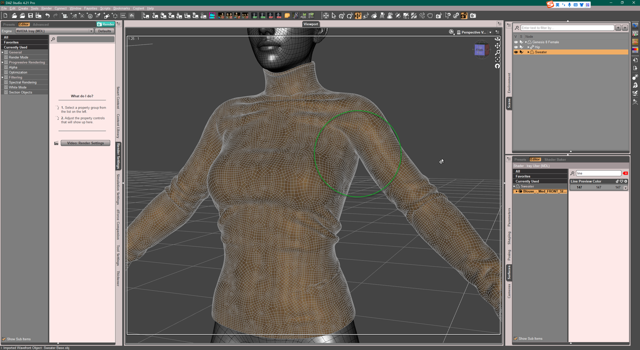

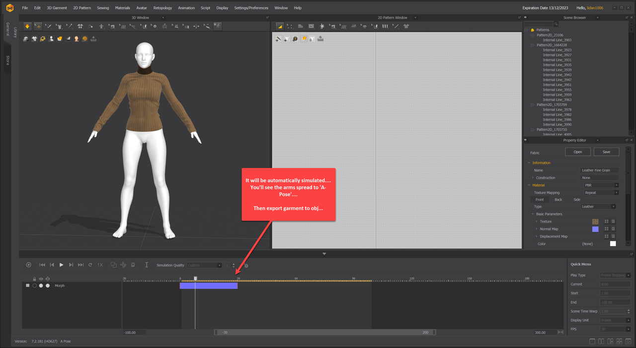

    If go for resimulation in MD with a G8F default A-Pose , more or less is as above steps by using Morph Target. Then export the garment to obj, import into DAZ for fitting to the figure with Transfer Utility (no need to set Current / Reverse Deformations in this way) . Lots of tutorials could be found on youtube.

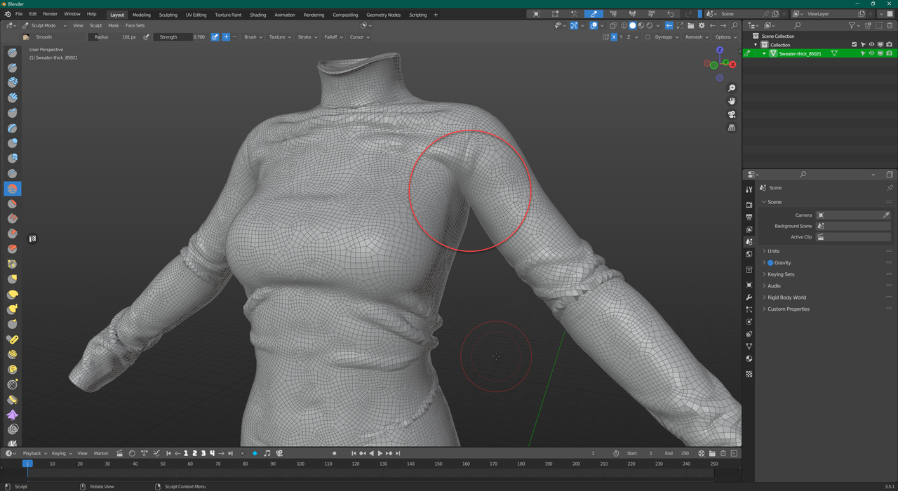

    Well since you're familiar with Blender, you may export the garment (in Pic 2) to blender, smooth the armpits with smoothing brush, then export to obj file. In DS, use Edit - Figure -Geometry - Update Base Geometry to change the Vertex Positions with the obj file. Done ~ Most of the time I myselft go for this way as it's faster...
    ~ I simulated your case as below, the mechanism is almost the same ~
    PS: You better do Quadrangulate in MD...

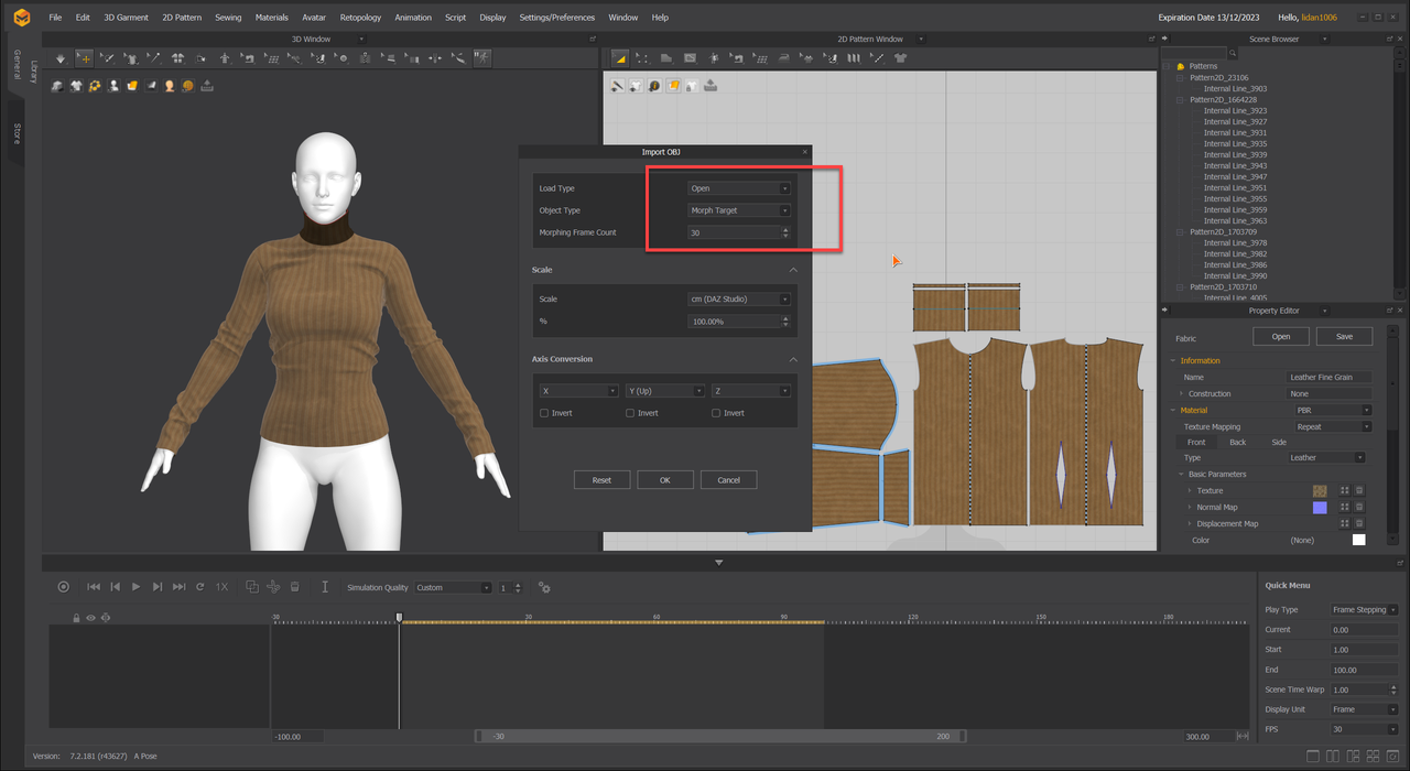

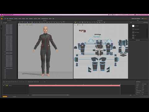

    edited June 2023
    lilweep said:
    • Resimulate to correct Daz default pose by either
      • (1) load avatar as morph target (your transition is likely small, so this is probably good option)
      • (2) delete current avatar and load a short pose transition animation in alembic format (check out Sagan alembic exporter on forums for a good animation exporter for Daz Studio), recording the simulation in the Animation window
    • Resimulate again so garment settles on new pose
    So I am clearly doing something wrong because when I resimulate the garment using an imported pose transition animation, this is what happens.
    Post edited by arstropica on

    that image resolution is really tiny to me, so cant see most details, but are you using high particle density (e.g., 10+) on all garment pieces to make animation easier?
    in any case, animation may be too fast.  In the animation box to the bottom right, there should be a time warp setting.  Increase that parameter to something like 5 or 6 to make it as many times slower.might help.
    Another thing, since it's very minor pose transition, you can also just select the whole sleeve or leg in the 2d window, and then move it in 3d window.  Move so the cuff is around the wrist. and then resimulate.
    You can also select everything and freeze everything. then select and unfreeze a sleeve/leg at a time. so youre just simulating one thing at a time, might make it easier to compute the simulation.  then unfreeze and resimulate it all once it is behaving a bit better.
    Post edited by lilweep on
  • crosswindcrosswind Posts: 9,739
    edited June 2023
    It seems not really correct... pls refer to the steps as below:
    I simulated such a 'appr. minus 15 degree arms bend' pose for the avatar... you prepare an obj file of G8F with default A-Pose beforehand...
    Post edited by crosswind on
    Hmmm... I followed your steps and this was the result...
    Is there something about the garment that is causing the distortion?
    Thanks.

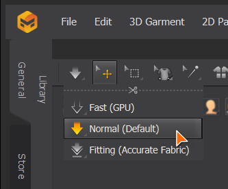

    Thanks.
    Pls use Normal (Default) to simulate...
    crosswind said:
    Thanks.
    No change with normal simulation setting.  Could there be something about the garmet properties that prevents it from moving with the avatar?
