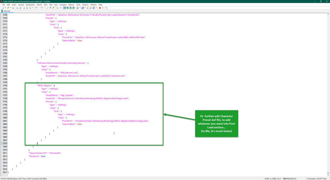

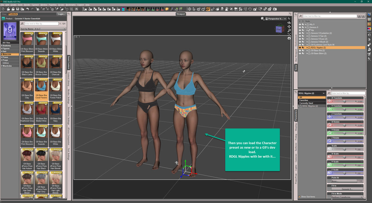

    OP: To your original question - most likely there are two ways to get it done:
    - to save a Character Preset + Post Load Script.
    - to save a Properties Preset + Post Load Script.
    It requires some knowledge of the data structure of the related products (better to know how to edit DSON user file), and there'll be a little more work, but it can give what you want.
    ...it comes to the routine time that uploading has strike... Anyway, as below:
    PS: You may add any Wearable (anatomy, geograft, geoshell, garment, hair, whatever... ) in this way... If you wanna add Pose as well, just use Properties Preset, the steps are always the same... However if you find this way too complicated, then just save a Character Preset + a Wearable Preset, and dbl-click 2 times... not a big deal.
