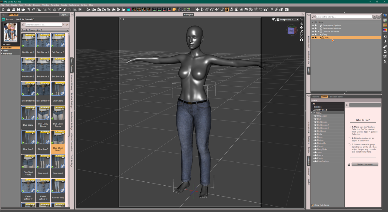

    Better refer to a product which uses such a technique, for instance, JeanZ... You'll get how it works, as below:

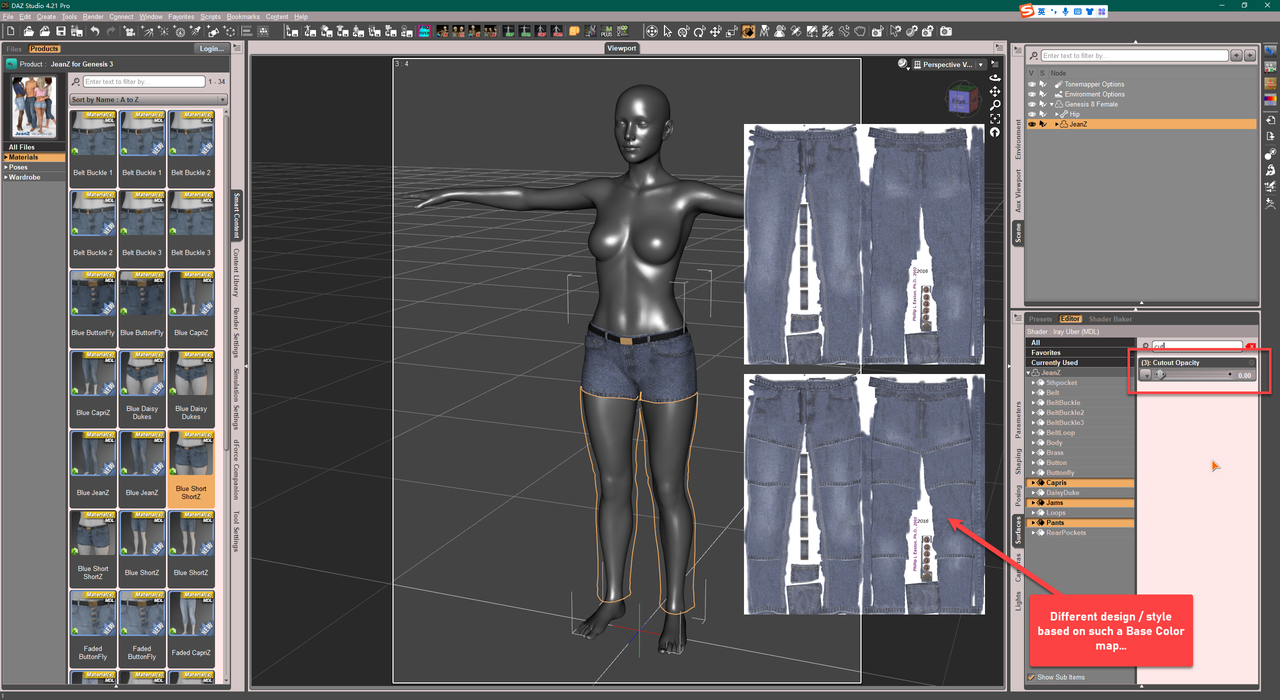

    ... with diff. texture maps...
    If you really wanna keep physical geometry / morphs (e.g. cuff, rim ,etc.) you surely can use modeling software to make them. But I myself would rather make separate piece of garments (one long pants, one short, etc.)

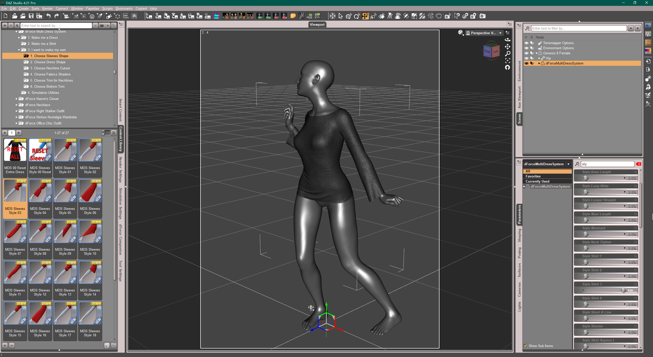

    Yea, as I said above, I myself won't go for such a way but there is a very product which completely adopted such a 'morphing' techniques, dForce Multi Dress System for G8F. I ever played those garments for quite a while and they did work quite well, only I just did not really prefer the design and styles... cheeky  Like these:
