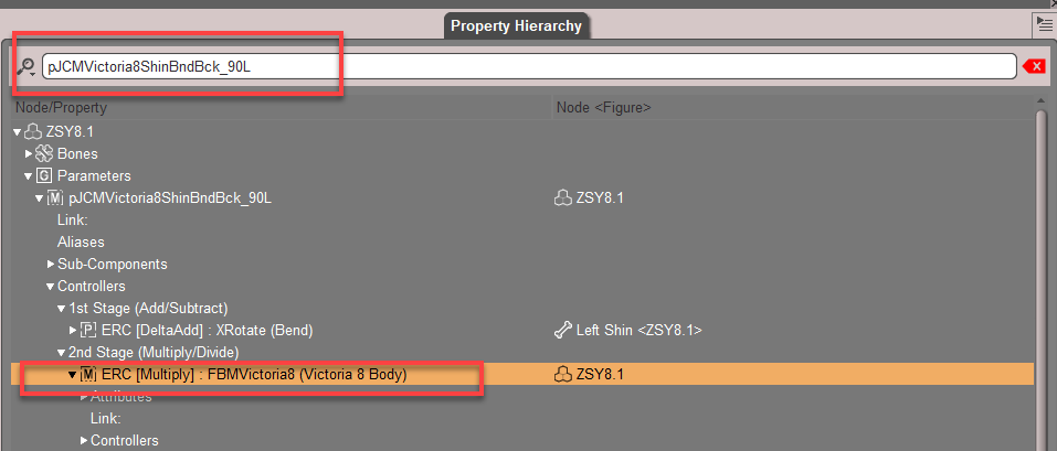

  • HavosHavos Posts: 5,600
    I have seen a similar issue with this on G8 as well, which is normally because I am using G8 in combination with these products: https://www.daz3d.com/turbo-loader-for-genesis-8-and-81 and https://www.daz3d.com/turbo-loader-booster-utilities.
    The first product renames a lot of dsf files so that they will not be loaded when G8F/G8M are loaded which significantly reduces load times. The second product makes the files readable again when reading in a particular character file. What I have noticed that if I have a bit of V8's head dialed into a character, then it will switch on V8s head morph and all of V8s jcms (both head and body), but not V8s cntrl dial or V8s body dsf.
    As a result any G8F character loaded later will often use V8s jcms even though none of her body is being used. This will cause deformations when the body bends similar to what was posted above.
    Since Turbo loader is not even supported yet for G9, that is not what is causing the issues for the OP. However if does show how the complexity and interdependant natures of the various Genesis morphs and jcms can cause some characters jcm dials to be non zero, even when there is no obvious reason why this could be the case. In my case it is no fault or error in V8, just a case of how some renamed dsf files can cause unexpected issues.
  • crosswindcrosswind Posts: 9,639
    edited June 2023
    I use Turbo Loader as well but haven't seen such an issue. If only dialing V8/V8.1's head morph, there won't be any V8/V8.1 body related pJCM triggered when posing the figure but only eJCM / cbs will be triggered if an Expression / FACS morph is given on 8 or 8.1. The mechanism should be all the same...
    edited June 2023
    crosswind said:
    Use the Turbo Loader manager to disable V8's body and character settings, but leave all the other morphs/jcms enabled. Then load a new G8F, do not dial in any morph, but pose it. Toggle show hidden values and you should see some V8 body jcms with non-zero values. At least I am, despite the fact that no V8 morphs are dialled in.
    edited June 2023
    Havos said:
    crosswind said:
    OK, that's it! V8's pJCM's 2nd Stage Controller is V8's Body morph (FBMVictoria8). If you deactivate the body morph in Turbo Loader, there'll be no 2nd Stage controller for V8's pJCMs... so they'll be triggered just by the 1st Stage controller, e.g. XRotat (Bending). Normally in Turbo Loader, we should deactivate all the morphs of a Character other than partially deactivation... as there're the 'control logics and settings' as above mentioned. I remember RiverSoftArt ever stressed that in the support thread as well..
    Post edited by crosswind on
    crosswind said:
    Havos said:
    crosswind said:
    OK, that's it! V8's pJCM's 2nd Stage Controller is V8's Body morph (FBMVictoria8). If you deactivate the body morph in Turbo Loader, there'll be no 2nd Stage controller for V8's pJCMs... so they'll be triggered. Normally in Turbo Loader, we should deactivate all the morphs of a Character other than partially deactivation... as there're the 'control logics and settings' as above mentioned. I remember RiverSoftArt ever stressed that in the support thread as well..
    That is all correct, and indeed only activating some is an error. However that is what the turbo utilities sometimes does when automatically re-enabling the morphs for a character being loaded. If the character used V8's head morphs, but not the body, then those two morphs I hightlighted remain disabled, and the posing problems start to occur.
    Okay, I'll further make some tests. If there's sth. wrong or a bug in there, let's talk to RiverSoftArt... cheeky (submit a ticket...)

    That sounds like a nightmare. I haven't been using G9 enough to notice that problem. I'll have to check it out when I get a chance.
