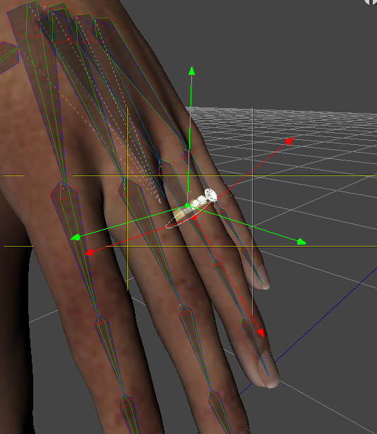

  • Richard HaseltineRichard Haseltine Posts: 108,524
    Is the ring a prop, with a single entry in the Scene pane, or a figure, with bones in the Scene pane?
  • JamesJames Posts: 1,167
    edited June 2023
    The ring is a prop.
    Anw by parenting, mostly it works.
    After a few investigation, the ring start to fly away when I zero pose the figure.
    I guess the ring also get zeroed.
    Then maybe I should change the question,
    How to keep the ring in place when the figure pose is zeroed?
    @felis
    534 x 614 - 294K
    Post edited by James on
  • felisfelis Posts: 5,917
    The origin is around the ring, so that should be ok.
    Does the ring also fly away if you restore the pose (instead of zeroing)?
    Restore keeps the ring in place. But, the body goes back to center of the world.
    I wasn't aware that restore pose, would restore character translations too. Seems illogical.
    So your ring stayes in place when parented to the right bone, when posing. But jumps away when zeroing the pose.
    I am sorry. No good solutions to that. You could save the default pose as a pose preset and apply that instead of zeroing, but is a little odd.
