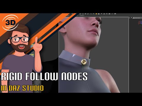

    So then I found this tutorial on youtube
    In this one you create a prop for each node. In my case I would need four (top and bottom left wing, top and bottom right wing).  I thought I followed it correctly but the wings still crinkled.
    Are there any other tutorials available that might help me make more sense of this?  Thanks in advance. 8-)

  • MadaMada Posts: 2,051
    edited June 2023
    This might help :) Its for glasses but it shows all the steps and how to add a weightmap, plus experiment with the best spots for the references
    edited to add : rigid follow nodes and rigidity are two completely different things - rigid follow nodes is best for items like buttons or pendants that is going to follow a specific polygon in a mesh.
    Post edited by Mada on
  • DeeceyDeecey Posts: 171
    Thank you very much Mada, that tutorial did the trick. Took 3 tries but I finally got it 8-)
    Awesome! Glad you got it working :)
