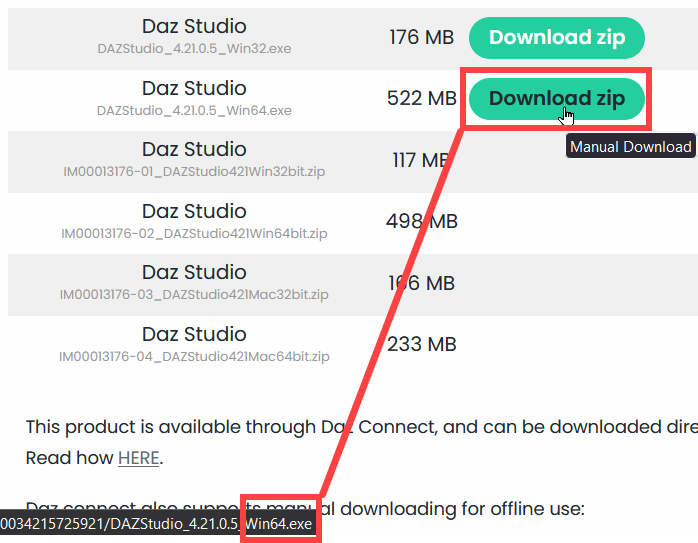

    I now tried to download the zip from my account page to put it into the download folder of DIM.
    But: The ZIP button is linked to an exe not a zip. So, this is also not going to work.

    @I.Am.NotStellar
    Sorry, late reply, did not notice there was a post.
    I can't remeber exactly, but I think you need the intaller zip and the manifest file and put them in the DIM folders accordingly.
    I set DIM to "work offline" for it to work.
    But anyway, I just checked "my product page" on the daz website and it seems there is no full manual download for DS anymore. Seems so they are DIM only now.
    Possible workaround:
    I made a TICKET on 12.16.2022 -- on 05.16.2023 (five month later) they posted a potential workaround
    1. Make sure DIM is closed
    2. Download and install the file from the link below: https://certs.godaddy.com/repository/gdig2.crt
    3. Restart DIM and try to install again.
    Maybe that works in case you still have the issue. I did not try it, but found my already mentioned own solution.
    Great an simple solution! I had the same issue and like this it was fixed in a minute. Thanks
