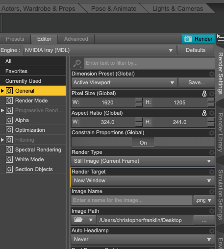

I have a render I am working on that seems to be acting as a wide-angle lens, the project is 8:2 (10000 x 2500) below are the settings. I COULD be imagining it, but I can't help but think I am not. any thoughts?

  • nemesis10nemesis10 Posts: 3,908
    edited April 2023
    My own guess is that, if you look on the Render tab, middle tab called Editor, top Parameter called General, it will say  "Custom" rather than "Active Viewport" so that the aspect resembles a wide angle lens rather thanthe camera actually being wide angle.  Use the pulldown to set it to "Active Viewport" if that is the case. Vendors often create custom aspect ratios for their products.
