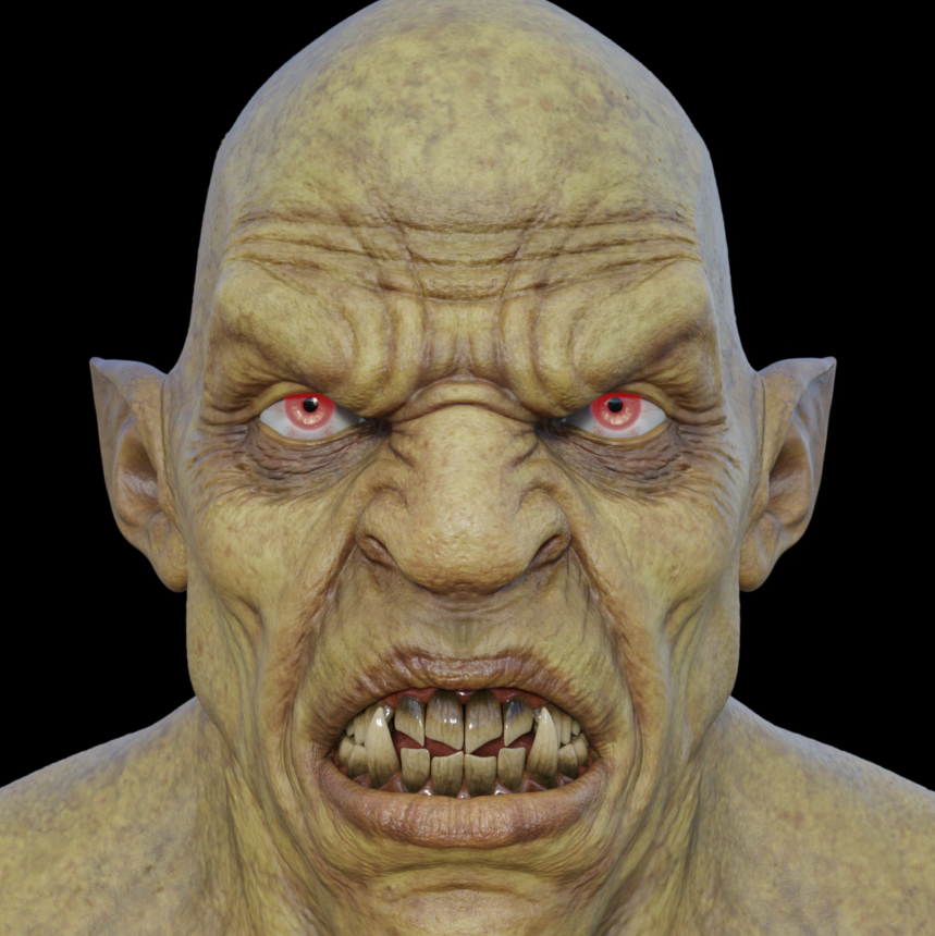

    Just in case I made a mask for you, an altered maks to show what you can do, and a render of the altered mask...  click on the picture to enlarge
    I will admit that the mask method DOES allow for some cool effects like grayscale fades and things like the above but to be honest, you could do that before as well ;)

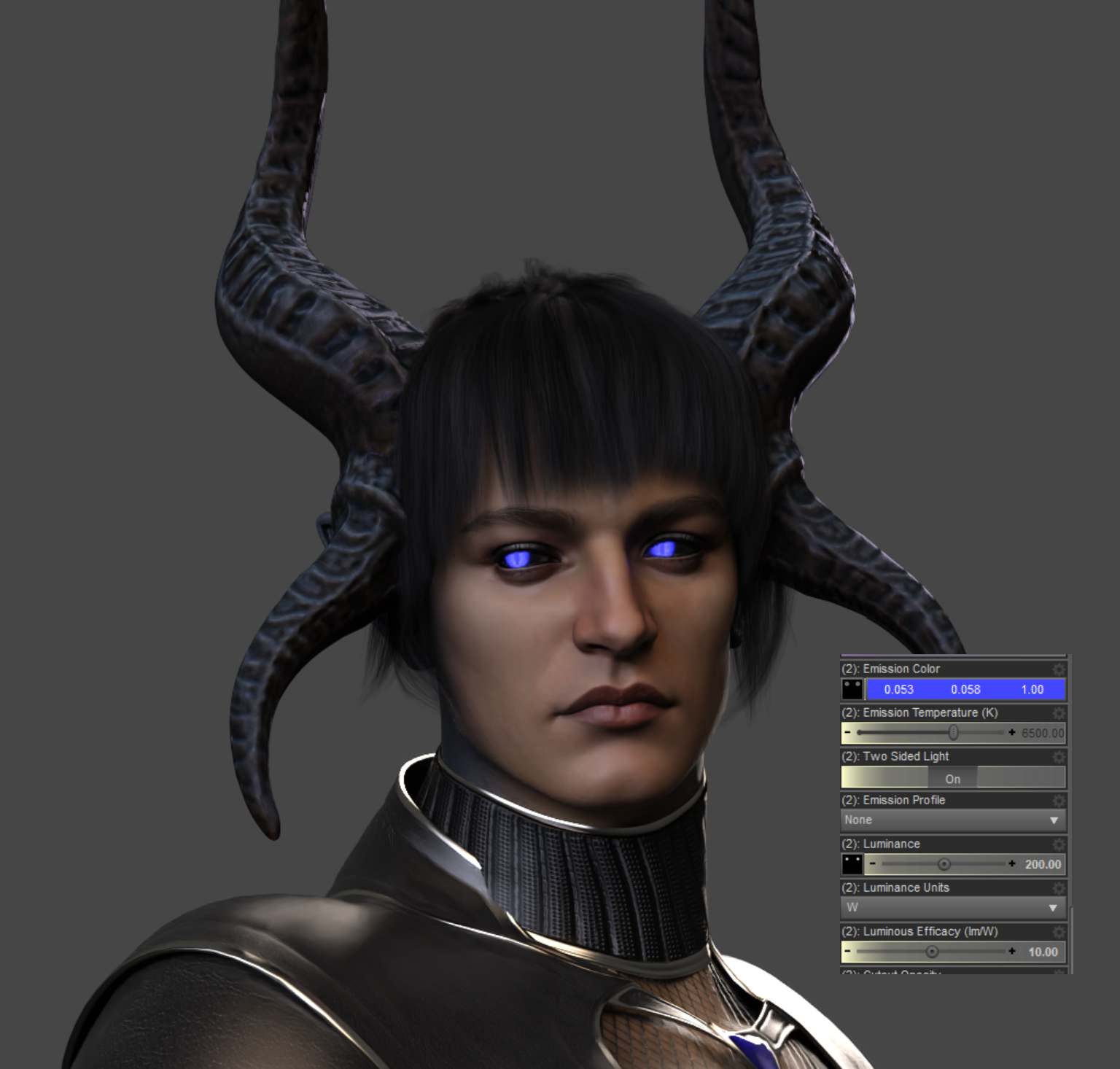

    One thing you can do to avoid having to hand paint masks--and that IMO results in a softer, more organic look--is to take an eye texture you like into something like Photoshop and make it grayscale, then mess with the contrast/brightness until you get the level of luminance you need (I wanted my demon characters' pupils to fade into the color, so I made that part gray instead of black). I usually use that in the emission color channel, then the soft-edged mask attached here in the luminance channel.
    Luminance units can make a huge difference in how the light looks, and I usually use W when I just want a soft glow that doesn't show through eyelids or overwhelm the face.
