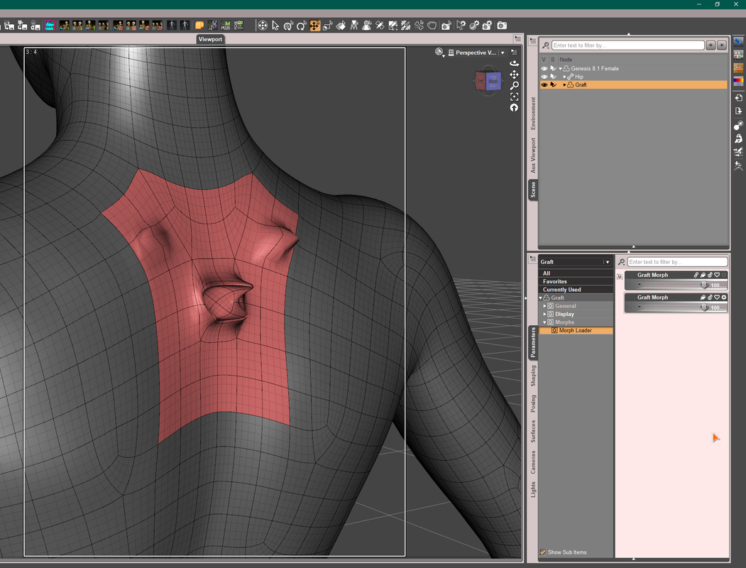

    The test graft:

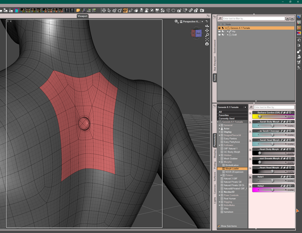

    I plan multiple modifications to the figure and a set of full body morphs, so I want to have them all on when I work in blender:

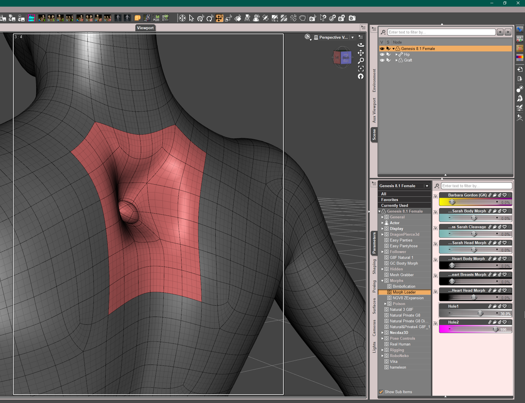

    I apply a morph for testing made on the whole model with graft in blender, it moves a region of the back.. back:
    Everyhthing works as desired except the spot with where the graft is does not try to conform to the graft and the vertices there are at default positions when I remove the graft:
    I don't even think that it should "work" and conform figure morph to the graft vertices morph on morph import.. but it sure would be nice as an option and actually makes sense in many cases.
    Not the best demo of what and why I need and how it looks, but there it is. I might just start modeliong the figure changes separately from the graft changes. I think it is fine and I can think of additional reasons to do so. If I ever see a bad transition then I can export both and import the morph for both. In most cases it might be fine. Just wanted to see everything together and work on it together and still be able to disable or swap grafts.

    Got it~ but still as above-mentioned, the figure's mesh cannot conform to the morphs on the graft. In order to make a seamless graft, we need to hide the relevant geometry on the figure. So I see no necessity to make a graft automatically force the figure's mesh to deform...
    In general, for a graft like the sample you posted:
    For some base or big range deformation, make the morph on the figure, especially when the graft is near a joint or the deformation is near the seam:
    For the deformation on the graft's unique mesh or some detailed mesh change, make the morph on the graft:
    Post edited by crosswind on
