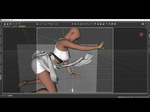

After the Dforce simulation, is it possible to disable clothing tracking for hand movements? Clothing without Dforce always adjusts to the movements of the character, but after the simulation Dforce sometimes I would like to somehow disable it, so that there were not such unpleasant effects as in the video example.

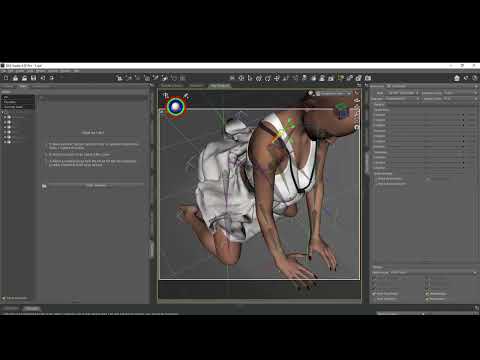

I tried removing the bones, but after removing the clothes changes its position, am I doing it wrong?
I also tried removing the weight, but it didn't work. I select the dress, then I choose the "Node Weightmap Brush tool", then I add a "Rigid" map and then the dress is grayed out. Sorry, because of my poor English I must have misunderstood :)
You need to simulate after removing the bones, so the figure needs to start off in a pose that fits inside the dress at least at the arm level.
The weights that would need clearing are the General Weights on each bone - the Rigidity map controls whether and how the model picks up on morphs applied to the base figure for which it doesn't have an equivalent.
