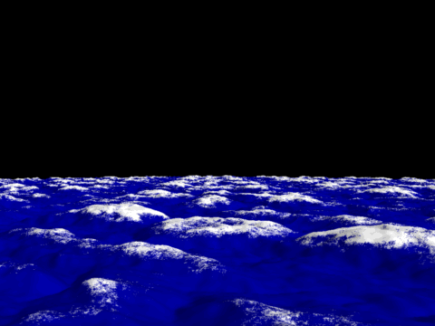

    So, here's what happens if you use a color gradient and a snow noise function on something with an animated change in elevation, such as the ocean primitive, or perhaps a terrain with a wave modifier.
    Evil - that looks very cool!
    Amazing EP !
    I'm very, very very... interested by your settings !
    I would imagine the shaders you made for your ocean would look much better and function much the same with possibly a little tweaking of either the wave height or the elevations in the shader.
    Amazing EP !
    Hi DUDU.
    I didn't save the scene as I just put it together very quickly and to save render time didn't add any other functions to the shader, just the color and the snow elevation noise shader, which I exaggerated purposely. If I were to do it for a realistic animation, I would be more subtle.
    I have some errands I have to do very shortly, which means that I will be gone for a few hours, but I will work up a better one and post the results.
