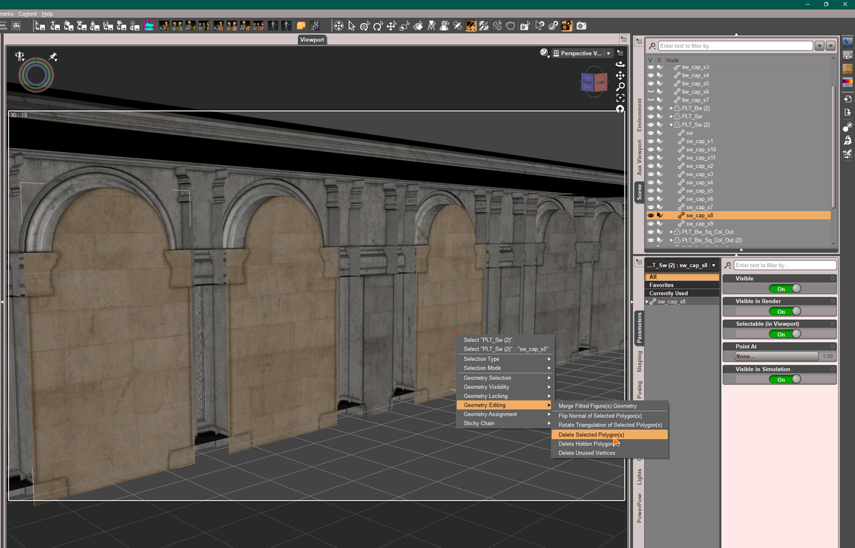

I recently bought Platea (Platea | Daz 3D). I am trying to remove some of the wall panels to expose doors and windows that are customisable, but after trying both wall sets I have found that it is not possible to delete individual panels by themselves. It seems it is possible to select them individually e.g. "sw_cap_s8" however after attempting to delete the Individual panel it seems everything in "PLT_Sw (2)" is deleted, with the same on the opposite side. I can only seem to have wall panels covering doorways or none of the structural arches loaded.
Is there any way to delete individual panels without deleting the parent object?

    A single sub-node cannot not be individually deleted in Scene pane. It can be.. by using Joint Editor but it will not affect geometry as it's just a bone~

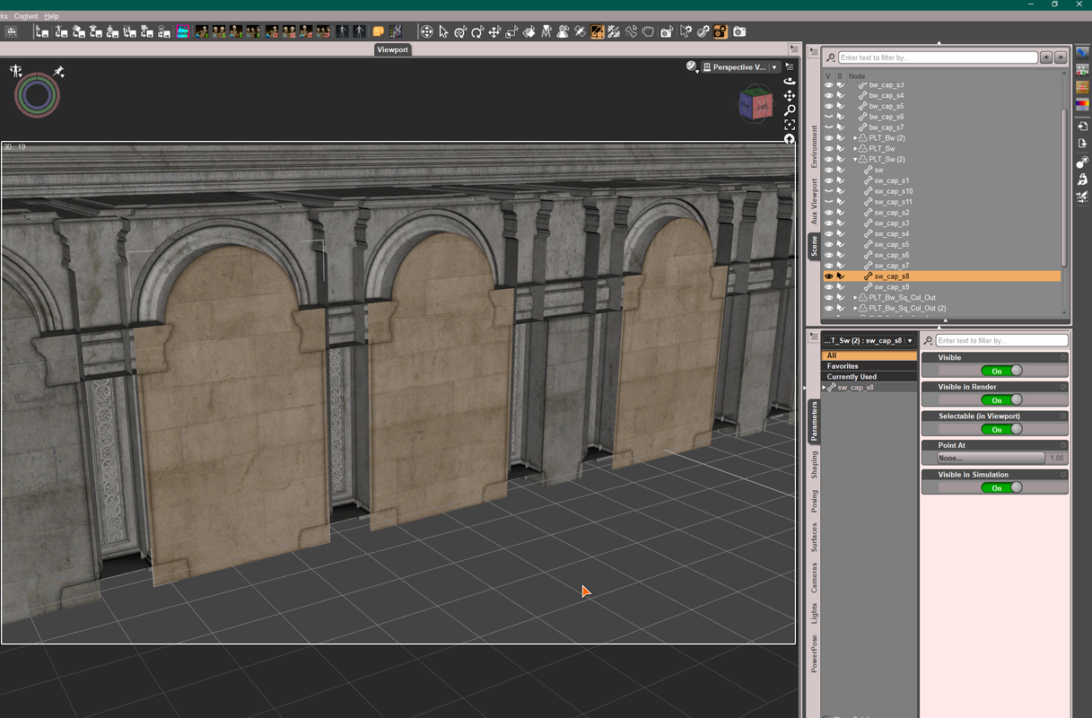

    Are these highlighted surfaces 'the walls' you want to hide?
    If so, why don't you just hide the nodes?
    You certainly can delete the selected polygons in Geometry Editor but it's not really necessary for this case...

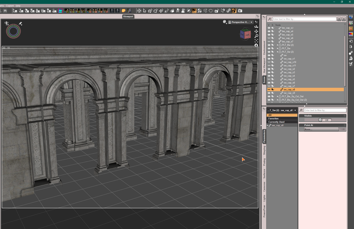

  • That solved it, thanks.
    Do hidden nodes still put the same load on the hardware as if they were visible or are they not accounted for at all during the render?

    The geometry data of hidden surfaces / nodes will not be loaded to VRAM of your GPU, as well as their independent textures maps. But they're still in RAM for sure~  For this scene, not a big deal~
