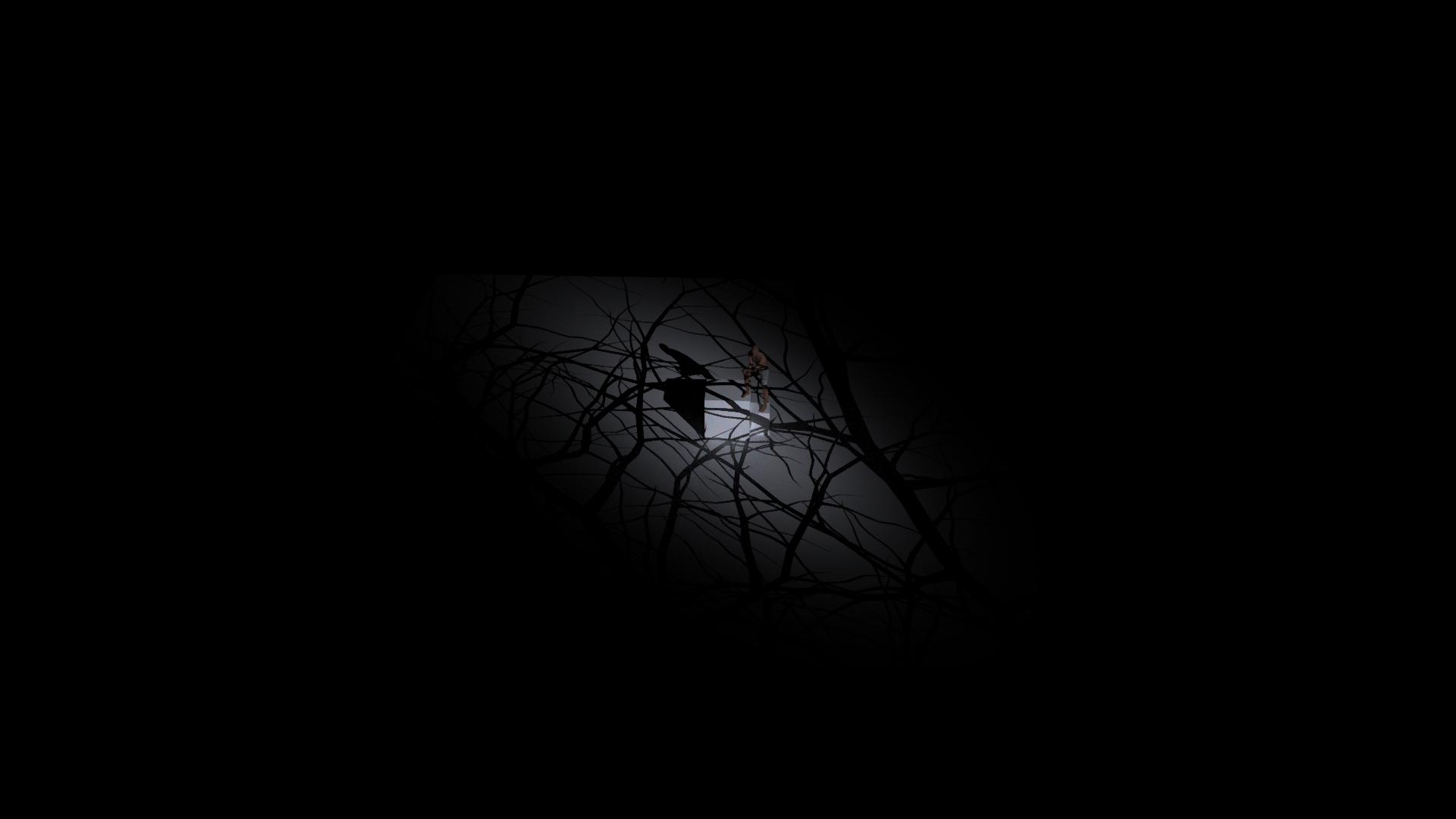

    Is it something like this you mean. Spotlight on right and I just stuck a leafless tree in front of it as I don't have any gobos :)
    Click on image for full size.
