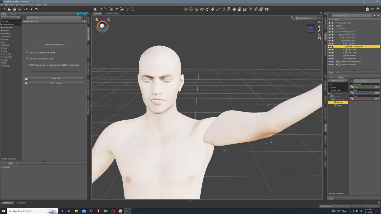

Genesis 8 male super deformed on twisting pose?
0 clue as to what is cauaing this but it's only affectiing genesis 8 males atm and just recently started happening. As you can see from screenshot any twist pose deforms and throws the mesh out of whack. Any help would be appreciated.
https://i.postimg.cc/Yq4h1Q4P/daz.jpg

    I assume this is the default G8 male.
    And it looks like you have an unwanted JCM activating.
    Have you installed any G8M recently?
    If you in the parameter tab mini-menu (3 lines) click and activate 'show hidden'.
    Then with the character selected, in the parameter click currently used, and it will show what is currently active and include the morph that is causing the problem.
  • It's default yes, does it on 8 and 8.1 male.
    Nothing recently I'm aware of. Tried reinstalling genesis 8 essentials to see if that would fix it. I followed your instructions but I'm not sure what to be looking for or to do if I find it.
    In the pic's you can see the deformation with the twist in red tab all the way up, if I move it to 0 it somewhat get's rid of the deformation as you can see n pic 2.
    https://postimg.cc/2bNJNGkY
    https://postimg.cc/n9hY79Fg
  • felisfelis Posts: 5,887
    I would say it is that 'red' morph you have changed that is the culprit, and is activating without wanted.
    Try to click on the gear icon and select 'parameter settings'. And then look at the file path, as that might tell which character it belongs to.
