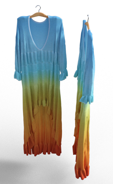

    Yeah - I just tried that and it needs some more work.
    I had to convert the Clothing form a figure to a prop, then re-add dForce. This then looked like it would work but explodes when hitting the hanger. So I added a weight node and de-painted a line at the top so I could sim with the hanger hidden. It probably needs to be done with a bit more finess than this mockup but it does seem to work.

    Ahh, OK, to do it the other way:
    • Select the clothing
    • Go to Parameters tab
    • Click on the "hamburger" icon in the top-right
    • Select Preferences -> Show Hidden Properties
    • You can then scale the Z axis independently
    You still have to sim the dForce but that's probably easier than the other way.
