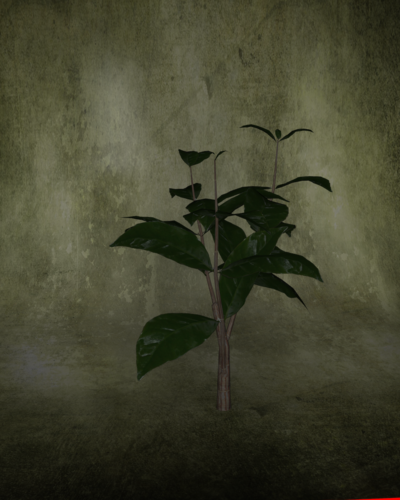

    Grab the freebies off the Xfrog site and try them out
    for DAZ you need the obj files and take the png maps and in Gimp, photoshop whatever create a black back ground white leaf mask image
    for the opacity channel, DAZ needs a shadermixer brick otherwise to see the transparency in png files
    Actully they have alpha masks...but they are inverted from what Studio needs...on these the opaque areas are black and the transparent areas are white. So while there is no need to create a new mask, you will need to manually invert them.
    Here's a quick render...the alpha maps were inverted to DS transmaps, and it was scaled up...no materials were tweaked.
    819 x 1024 - 1M

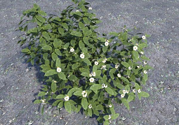

    I grabbed some freebees in obj format over a year ago. I also found that the alpha maps were reversed but it wasn't difficult to pull them into photoshop and invert them. I then imported them into DS and saved them in my plant library. Below is a sample.
    1200 x 840 - 1M
