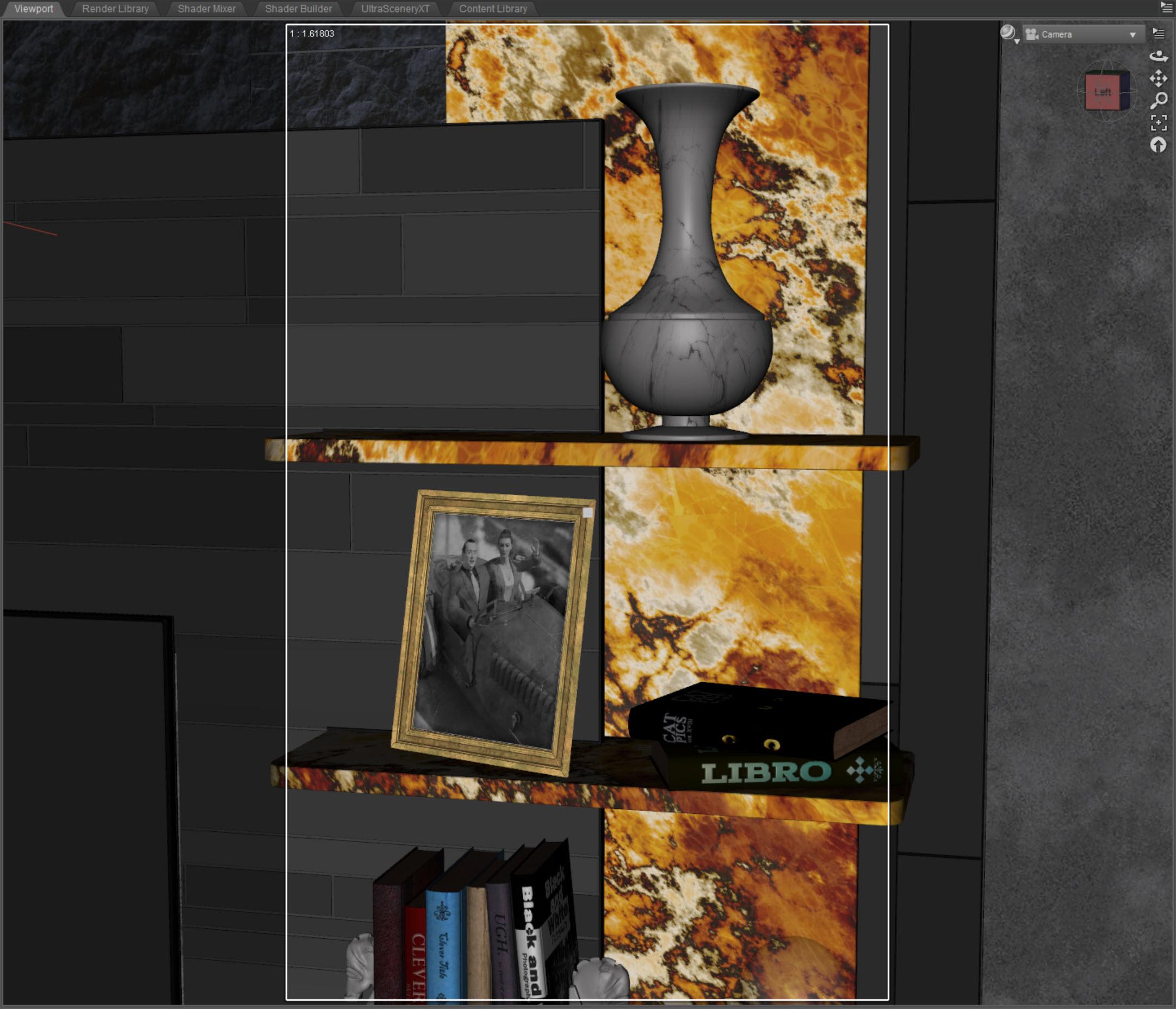

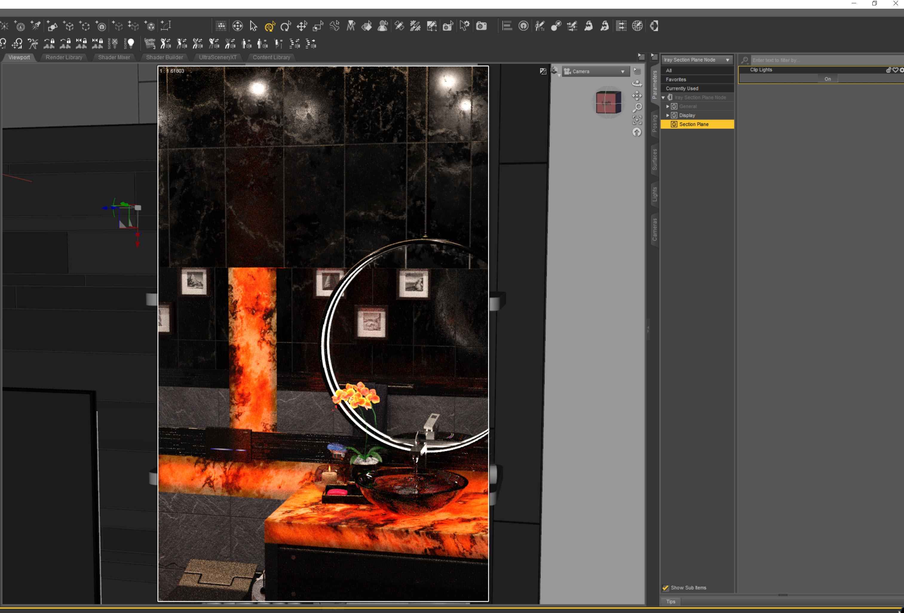

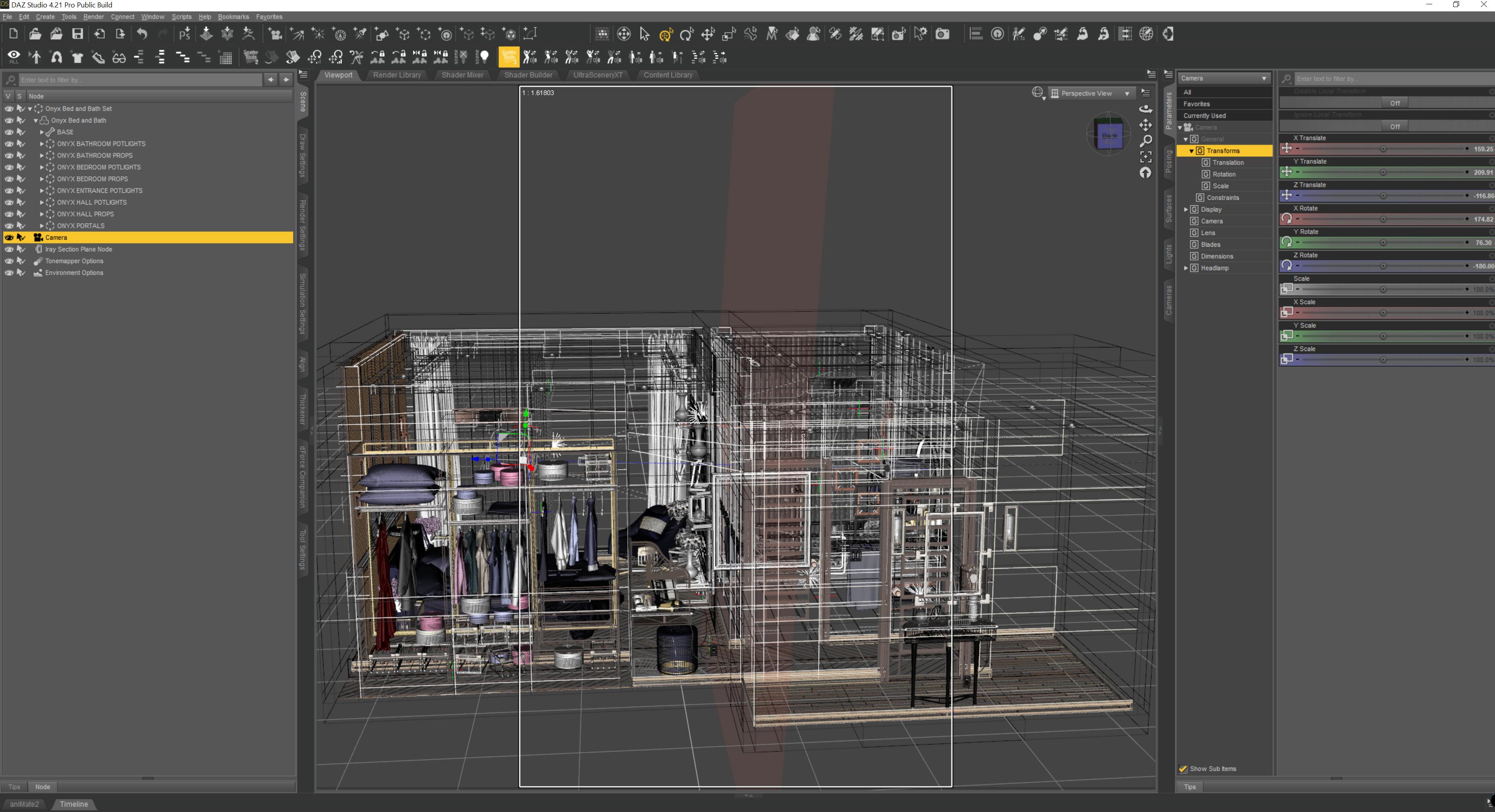

    @marble  Here is a quick illustration of how it works using Hole's Onyx Bed and Bathroom as example: The first image shows the side vioew in wiremesh. You can see that the camera is in the bedroom pointing towards the wall (where the move tool is). The section plane is just behind the wall between bed and bath. The second imgae shows the view of the camera in texture shaded mode. You see the bedroom wall.  The third image shows the iray preview with "Clip Lights" on the section plane OFF. You see the mirro shows the sky dome because everything in front of the section plan is cut off and invisible. That last image shows the same view with "clip lights" ON. Now you see the bathroom wall refelected in the mirror and the only light comes from the lamps in the bathroom.
    Hope this helps
    Ciao
    TD

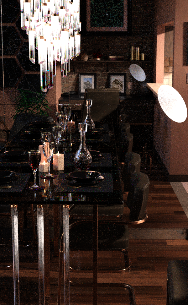

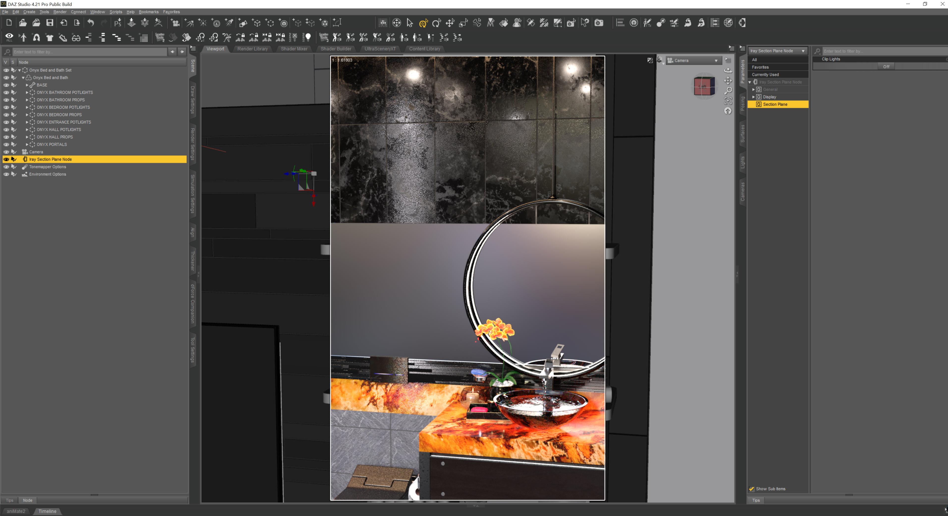

    Now, if you can tell me how to stop spotlights being reflected in windows and mirrors (no section panes involved) - I'll be an even happier old Hector.
    @marble Not with regular spot lights. What I do in this situation is to use the Dishlight from Iray Ghost Light Kit One https://www.daz3d.com/iray-ghost-light-kit-one Scaled down it makes a nice spot light. Here is a quick example using Hole's Crystal Loft which has lost of mirrors. The first image has the dishlight pointed at the candles on the table. I have craked up the power way high to make the effect obvious. For an actual image one woul;d turn it down. As you can see neither the light source nor its reflection show up. The second image shows the setup with the dishlight having a white texture to illustrate where it and its reflection are located.
    Ciao
    TD
