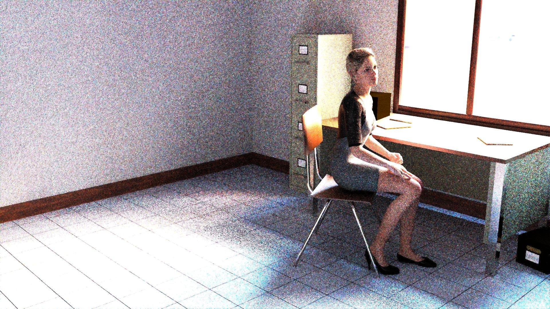

    Is it something along these lines you are looking for.
    Tone Mapping is 128/16/100 and I made the lights in the ceiling Emissive and set them at Luminance 10, Luminance Units cd/cm^2 to get some light in the shadows. For more interior light increase the Luminance to 15 or any number that gives you the lighting you want.
    2022-10-27 21:11:29.520 Total Rendering Time: 3 minutes 43.43 seconds
    Click on image for full size.
    1920 x 1080 - 924K
    Post edited by Fishtales on

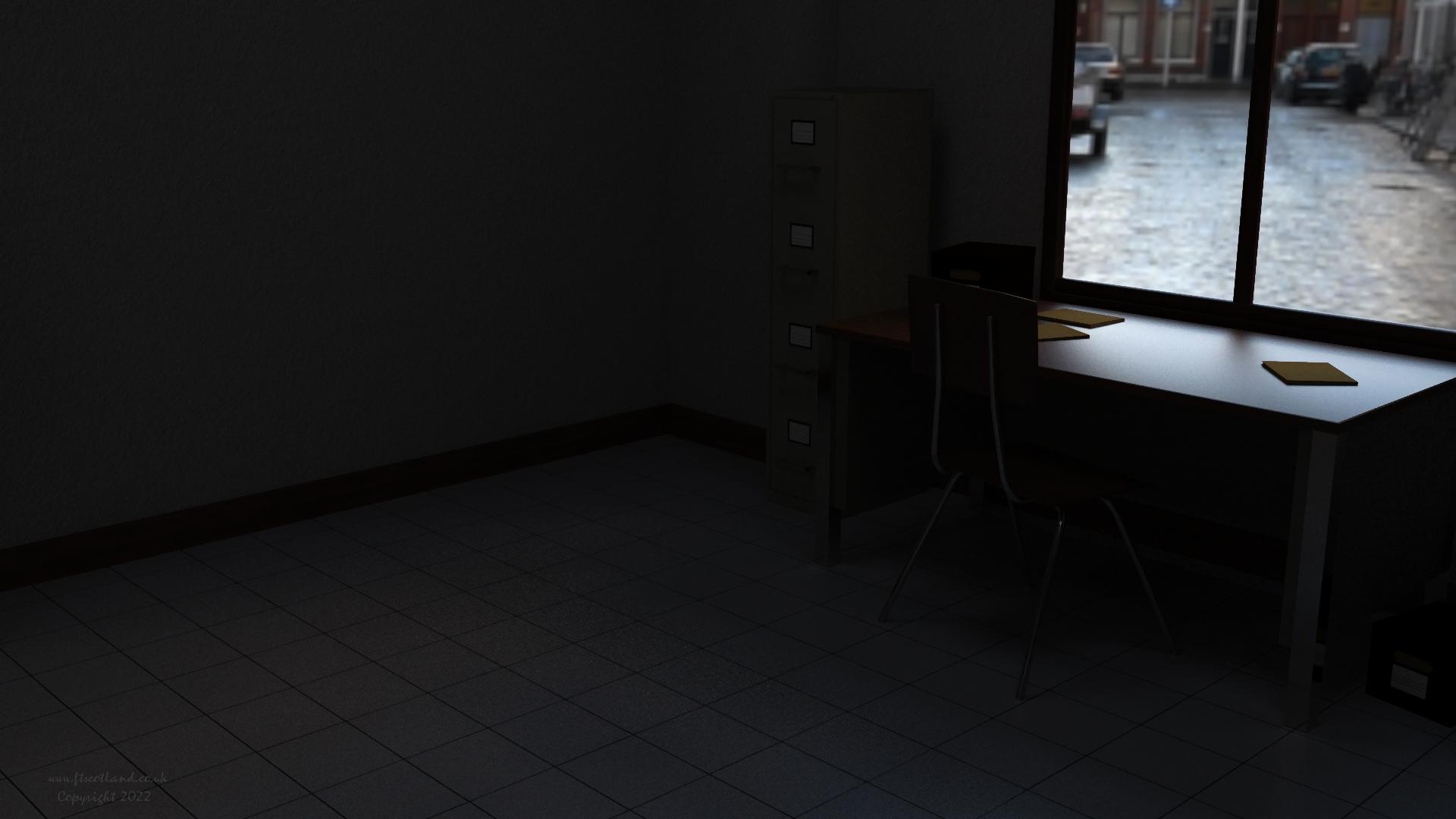

  • FishtalesFishtales Posts: 6,212
    edited October 2022
    Yeah that worked...not. I had to stop it after 4minutes and it was only 25% converged and there is no sign of the HDRI outside the window.
    1920 x 1080 - 3M
