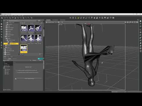

I'm trying to build lekku for G8, but I keep getting this error.  If I move the hips, the geograft follows the figure.  However, if I move the figure itself, this happens:

    It's caused by adding a smoothing modifier to the geograft.  I've noticed on other geografts.  Turn off smoothing, and everything works fine.  If you must have smoothing, you cannot move the figure.  You must move the hip instead.  The figure must always be centered.

    So I ran some tests, and indeed: If we load a G8, add a geograft to it, then add a Mesh Smoothing to the geograft: the geograft moves back to the center of the scene rather than following G8's movements.
    If I also add Mesh Smoothing to G8, it's even worse. Computer Fans accelerate, Geograft is sometimes properly attached when moving the viewport, but resets to center when one stops moving the viewport. When G8 is selected the brackets around it constantly blink and the computer clearly struggles to compute something that's constantly asking for resources.
    Applying Mesh Smoother in the info bar stays at 0% but contantly blinks. Deleting the Genesis or Removing Mesh Smoothing instantly calms down the fans and fixes the issue :/
    Well... definitely something wrong here.

    @hansolocambo, I think you should be the one to put in the bug report. Your screenshots show the problem the best.
    Sorry I didn't include this info in the video although it definitely sounds important and might help devs to eventually fix that someday.
    So just in case it matters :
    - Move the Genesis' root, or the Genesis parented to a Null : and the problem occurs.
    - Move the Genesis by grabbing only its Hip or Pelvis : and the problem does not occur.
    I submitted a detailed ticket about that issue with links to that thread and the video.
