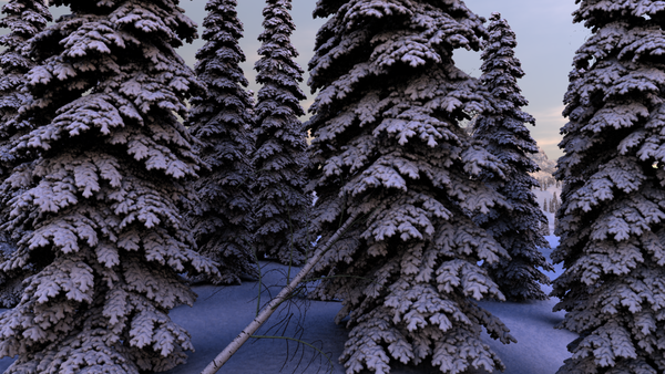

    Thank you all for your help. I managed to render my first scene in Carrara, granted it was Howie's Snow Scene but I did tinker with it some
    1280 x 720 - 2M
