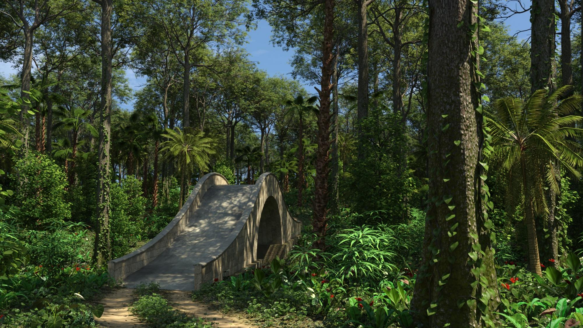

    edited September 2022
    Yes, I was using sun-sky at 11:30 AM. It is basically the default lighting provided with the UltraScenery product.
    If you reevaluate the surface settings, I would suggest dropping the displacement. Iray displacement is not useful on such low resolution mesh. Look closely at renders and see if the displacement is doing what you expect. I think it is not.
    Thanks for noting the texture map source and usage rights in the readme.
    I modified my scene. The bridge is in much more shadow now. I darkened the base color of the light surfaces and added some dirt overlays. It blends in nicely now.

  • That looks cozy in the forest :-)

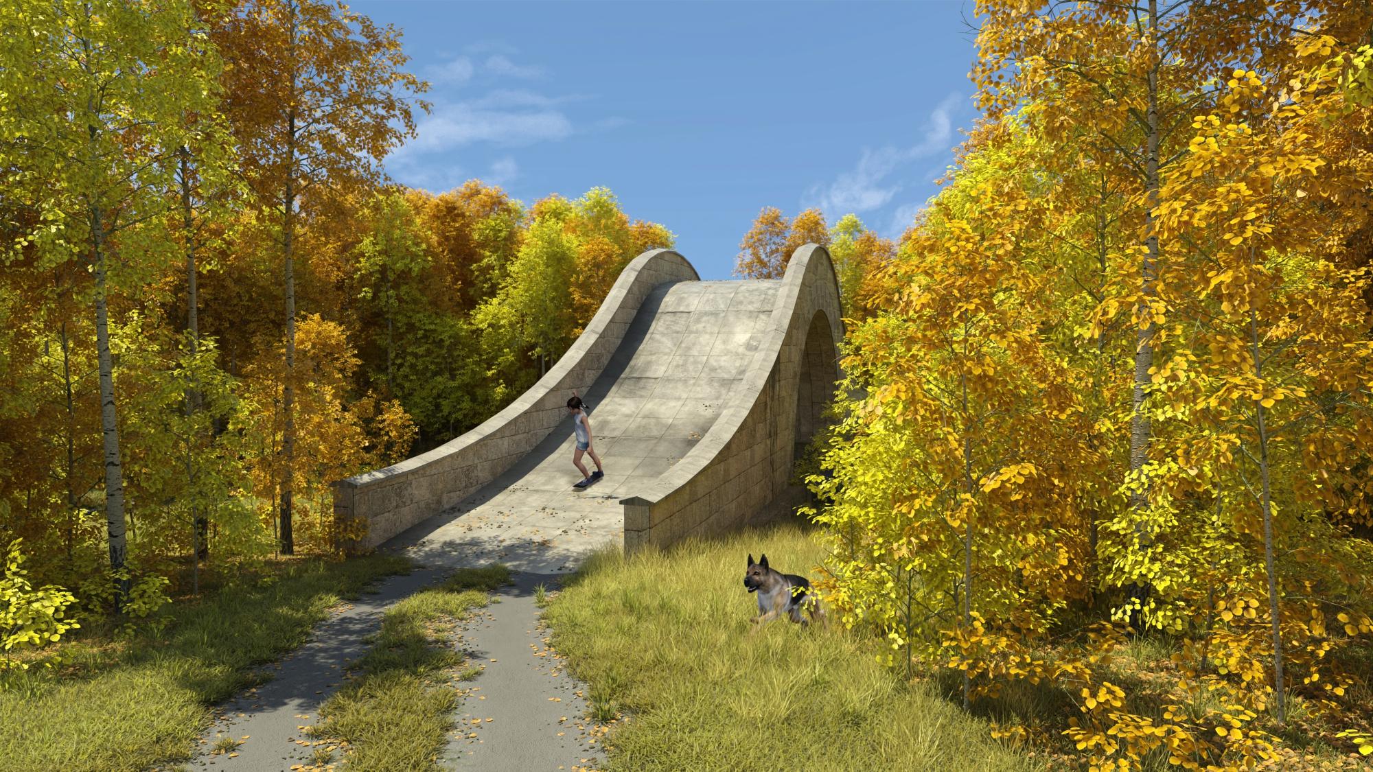

    Ooooh, that's a steep bridge.

  • richardandtracyrichardandtracy Posts: 7,300
    It is a very steep bridge. The proportions are as close as I could get to the photos I could find of ancient Chinese bridges. The only difference being the real ones have steps. But, I felt that would preclude any chance of amusing images with the bridge used as a vehicle launch ramp because a driver misjudged how humped the humpback bridge was, and there is a 'car themed' freebie challenge this month. Regards, Richard.
    Post edited by richardandtracy on
  • barbultbarbult Posts: 26,414
    Ah, steps. That makes sense. It makes a good skateboard ramp without steps, too. wink
    It is a nice bridge. Thanks for sharing it.
