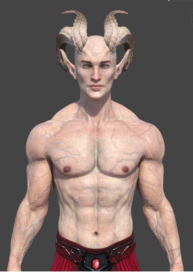

Hello All, I have created the horned fellow below using the Leonard / Torment figure base. What I had noticed is that when I applied the veins to the body, they don't seem to render right.  The veins are supposed to bulge out which is shown in the picture of Leonard in the Daz Store here:
Now when I have done my render of my character, not all of the veins look like they are protruding, in fact some look like they are doing the reverse, but most seem to be very flat looking, nothing like the render above:
As you see, the face is nothing like the render from the Daz Store, all the face veins seem either flat or "inverted".   Now the weird thing is that certain areas, such as the right forearm, look fine. The left wrist and shoulder look OK, but for the most part, the entire torso area, face and most of the left arm doesn't look right.   I am wondering if there might be something off with my settings that I am not getting the results as pictured.  And yes, I have the SubD turned up to 4 when I made that render, so that isn't it.

  • felisfelis Posts: 6,131
    Assuming they are sculped with high resolution. What subD level are you using?
  • MoogooMoogoo Posts: 136
    it is your lighting, try more angled lights and shadows to bring the details out

    I've also noticed that odd inversion effect with veins, etc. I'm not sure whether it is Displacement or Normal Maps but they look like they are indented in the skin rather than raised. Nor so sure about the lighting explanation either because I've tried different camera angles and lights and HDRi and they still look inverted. Most of the time it is not enough of an effect to notice but occasionally I spot it and then can't stop having my attention drawn to it. I even start suspecting it is an optical illusion and that my brain is doing the inverting but I don't really think that is the case.
    I have to say that I am pretty sure that those I have trouble with are not HD but are Displacement and/or Normal maps.

    Looking at Leonard now, subD isn't the issue, because the veins are entirely texture-based, and there are no displacement maps, just bump and normal.

    1) SubD is at 4.  I could go to 5, but then rendering takes a VERY long time.
    2) Lighting:  I have noticed that lighting DOES have an effect, but I can never get the veins to look like as on the picture for the product sales.  It is weird because then the raised look changes.  In other words, if I change the lighting the opposite side, then the veins that look inverted come out and look right, but the ones that looked right with the opposite angle now appeared inverted.   So I do agree that this has to do with the texture, but is there a way to fix it, because the main photo shows nearly all of the veins to look right.
    3) Bump maps:   Would changing these fix the value?  Doesn't the bump maps raise the detail surfaces of the skin?  @Gordig,  Could one use the bump and normal maps for displacement?  Would that work.
    4) Changing Shadows:  @Moogoo.  How do you change shadows?

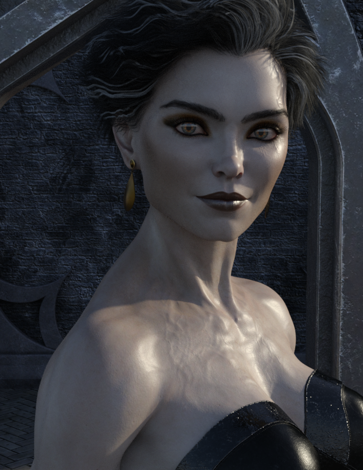

    With the character "Rachelle" which is a vampiress that is created by Mousso, her veins appear normal, but yeah, you do have to angle the light right.  (See Attached)
    The vein details are awesome, particularly on the second one.  They all look right too.  Not only on her chest, but the side of her face too.   Here with this figure, the angle of the lighting does matter as the effect isn't as great with full forward lighting.  The more to the side you go, the better, but it never has that concave look.  The veins all protrude.  (And yes, I DID model the vampiress after Madonna).
    Summary:  Okay, so now I know the problem isn't me, so how can I fix the issue with Leonard?
