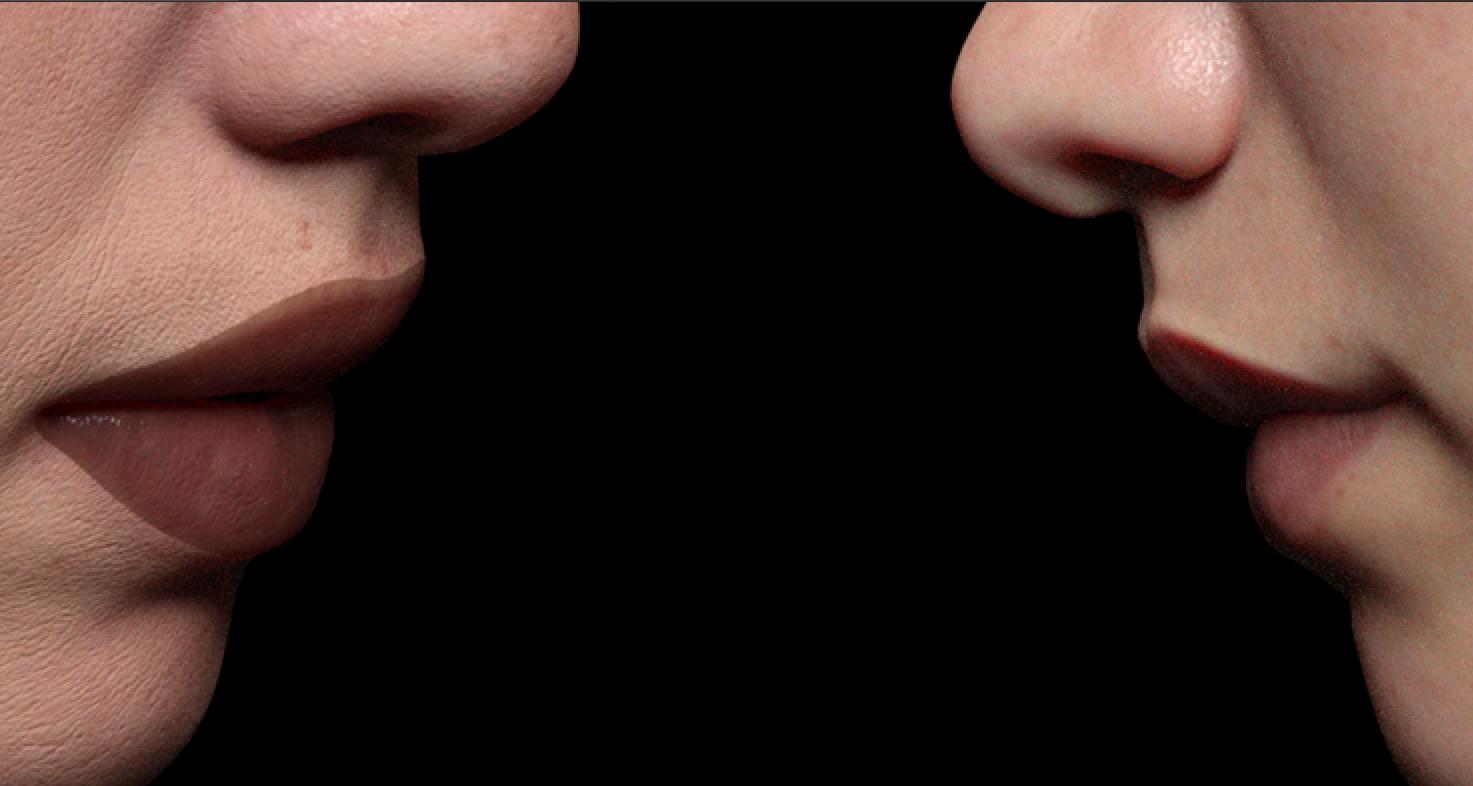

I have noticed that Sahel's Lips are not great up close which ever makup option I use i get a hard line to the lip colour and it does mot quite line up with the lips themselves.
In the screen shot Sahel is on the left and Misumi is on the right and both are straight out of the box should sahels lips look better or is that how she is meant to be?
I have not used Sahel so close before so never noticed this till now.

    It seems to me there must be something off in your surface setting, that one of your colors where there is a map texture, isn't set to the correct value. You can also see that the lips are darker.
    I loaded her and the first image is straight after loading. The second I tried to apply a lip color, chossing the darkest of hers, but there isn't one as dark as yours.
    You could try co copy the face surface to the lips.

    interesting no mater what i do i get this hard edged lip and the skin never looks as good as it should. I might try uninstalling and reinstalling ehr to see if that fixes it?

    Yeah I think that's the culprit. The lips being a separate surface means you are going to get a hard line around those polygons if you change the color. A better way to customize the color would be to copy and edit the head texture, or use some kind of layered makeup product.

    I just had a look and the reason why this happens to her lips is when the Translucence weight is moved all the way to the right, to 1.
    As you can see, I then get the exact same results as you have, with the lips.
    Maybe you accidentally moved the slider to the right, set to 1.

    OK figured it out
    I reapplied the skin preset from materials in smart content and all was well.
    Then I rememebred i had read in the forums how to lighten her up a touch and i had lowered the skins translucency by about 10% and this had given the mouth its hard edge so putting it back made all well again although darker.
    So the long and the short of it is it was my fault blush

    If you want her skin lighter, you can try reducing the TW for the lips and nails, along with the skin.
