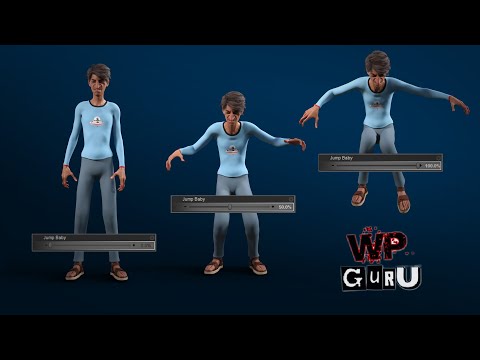

    I watched a tutorial video about using timeline and keyed ERC.
    But that like turning the timeline into a slider, where when we move the slider, it animate the character.

    I read a PDF about sequential ERC.
    A controller is like a master controlling subcomponents like a slave.
    An example of a  controller is a Bend slider.
    A subcomponent is usually a morph.
    In sequential ERC, one controller activate multiple Sub-components  one after the other.
    Let's say there's 2 morphs / subcomponents.
    Morph 1 starts when the bend slider value is 0 - 45
    morph 2 starts when the bend slider value is 46 - 90.
    I think this will cover the idea of making an intermediate morph.
    So, anyone know how to set this up?

    Keyeds ERC can do it, or careful use of limits and constant values can do it if the morpsh are designed to stack. Keyed is probably easier.
