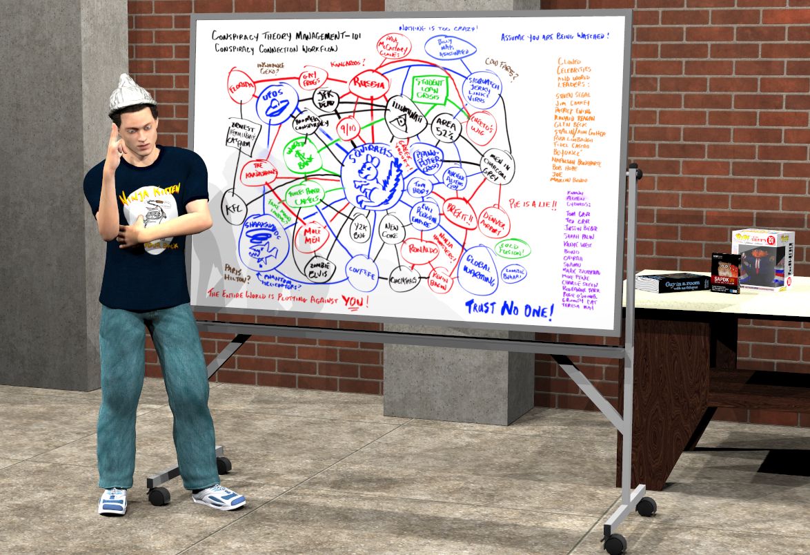

    If you have a scanner in your printer (if you have a printer), take a clean sheet of white paper and a sharpie, write whatever you want on it, scan it and open up the image in whatever image editor you have, desaturated the image and increase the contrast until the lettering is as black as it can be and the white as white as can be, save that as a separate layer and then delete all the white leaving only the layer with the black handwriting... then bring that layer over into the whiteboard's UV map, size or adjust, etc and flatten the image.
    I used the method Gordig described to create the map for my whiteboard model (below), but if you don't have a tablet or smartphone, that's something else... if you do though, there are lots of apps that would allow you to do this... Sketchbook by Autodesk is free and available for Android and iOS, and works great for this particular task.

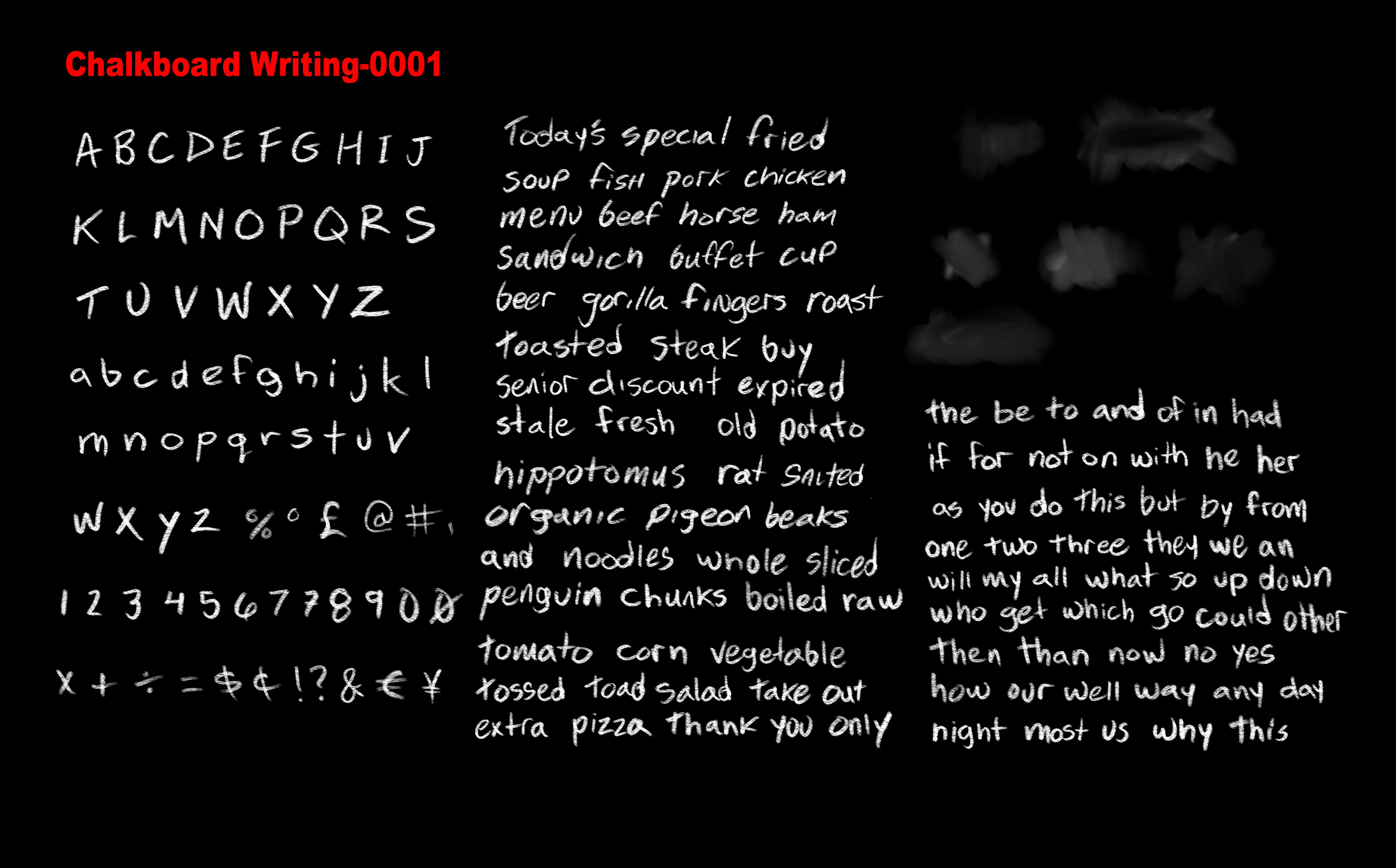

    Here's a chalkboard version too... same thing as before just made using a "chalk" brush to write with.
    It was made for a menu board, so that's why there are so many food related words like "soup", "fried" and "organic pigeon beaks"
    Again, its 100% for Commercial use, no non-commercail or editorial use nonsense.
    Also... it sucks, so it is what it is...
    Use the PNG in the zip file, not the above JPIG...
