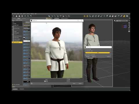

So I have an odd issue that my renders for some reason wants to finish really fast, leaving the render incomplete and grainy. I've tried different resolutions and adding more lights, but nothing seems to fix it or make em load longer. I've tried both leaving render settings at default, but also upping max samples etc. Also even if I enable Post Denoiser it uses roughly the same render time, while if I remember correctly, it should be MUCH faster due to the denoising effect it applies?
- video showing both types of settings I've tried, with different resolutions (golden portrait ratio + full hd)

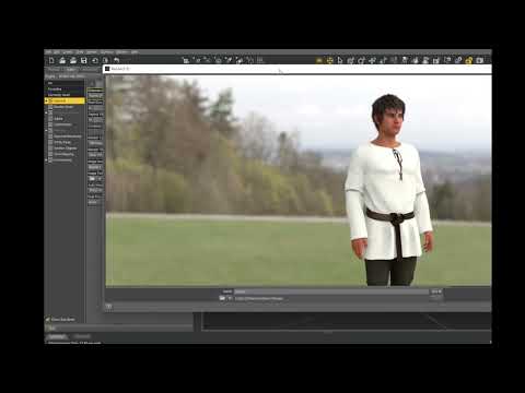

- video with more lighting
It's a bit  hard to see the graininess in the videos, but here's the "finished" render -

    Huh, interesting. I tried disabling Rendering Quality, and it now seems to be rendering properly. I have no idea why that is, as I've always had that enabled without issues. Here's a before and after :)
