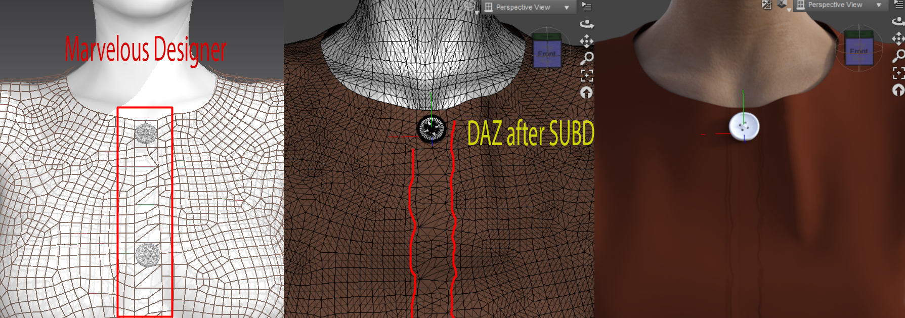

Hey, after I applied Subd to my clothing, the part that should be straight becomes curvy.
Is there a way to fix it?

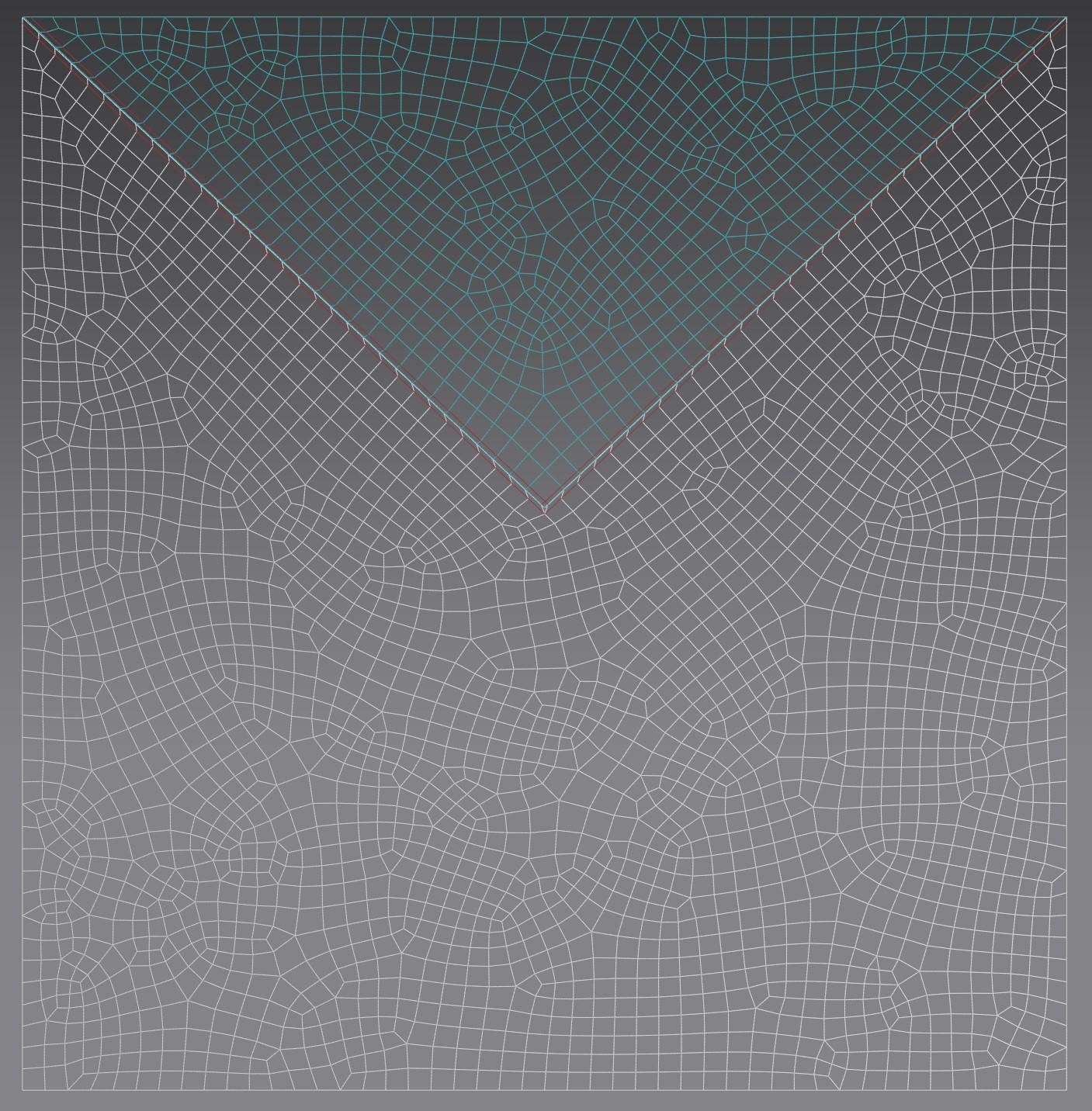

    Marvelous Designer project with two pattern pieces seamed together:
    This is what the pattern pieces look like in the MD 2D design window when 2 mm offset internal lines have been added along the seam lines. This is a screenshot of the MD 2D window.
    This is what the pattern pieces with internal lines look like in the 3D window with the pieces seamed together and quadrangulated. This is a screenshot of the MD 3D window.

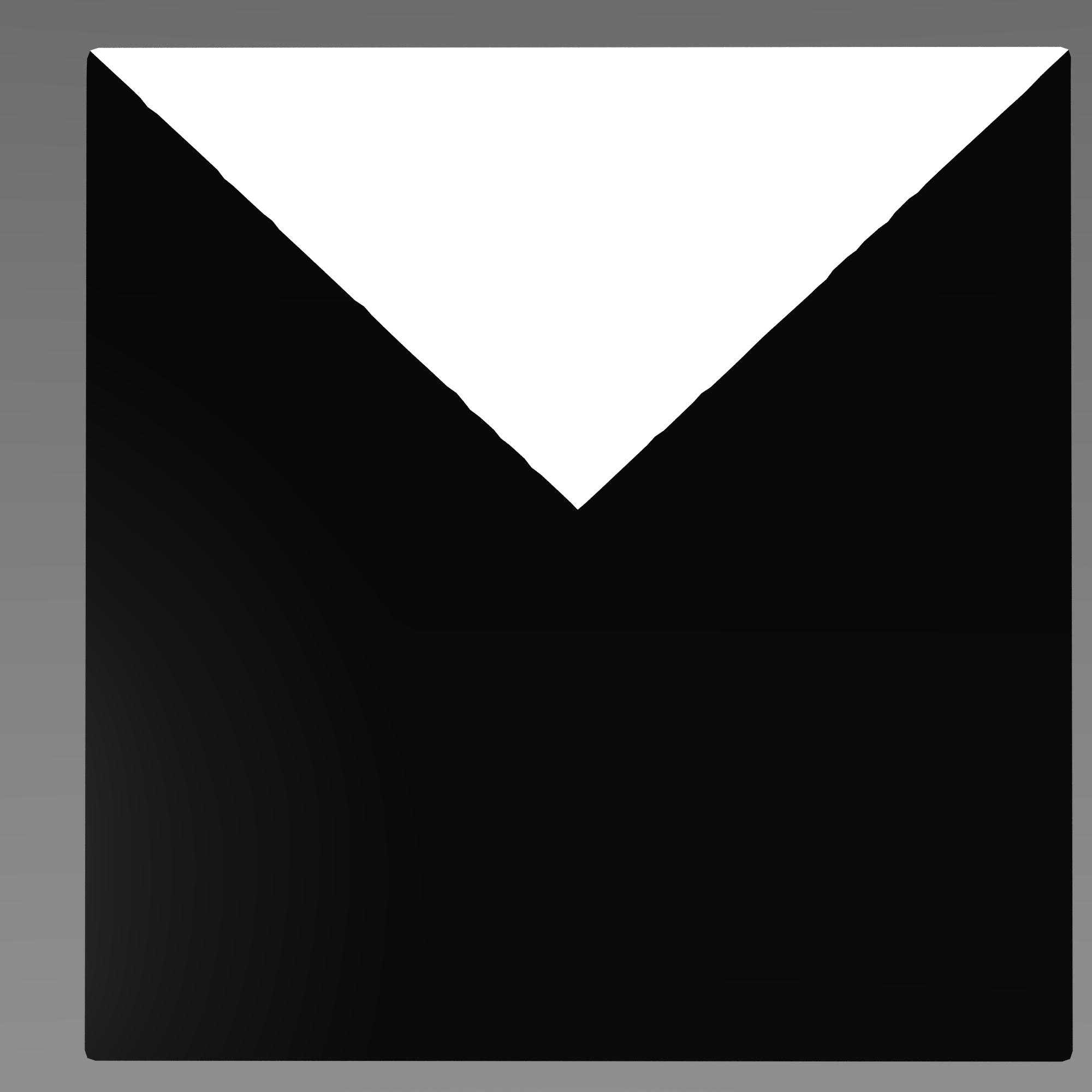

    When imported to Daz Studio and Subdivision is applied (SubD 1), the seam line is quite straight. This is a DS render.
    For comparison, here is the same two pattern pieces without internal lines along the seam. When imported to Daz Studio and Subdivision is applied (SubD 1), the seam line is quite irregular. This is a DS render.

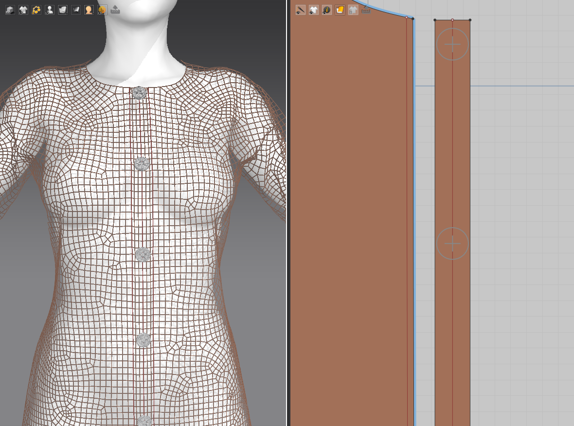

  • JamesJames Posts: 1,171
    edited August 2022
    Yes, it works.
    Adding internal lines on MD makes the quads more regular.
    Although in my case, for the long strip pattern at the middle,
    I added the internal line right at the center,
    else irregular quads still occured,
    causing the curvy SubD.
    This problem is solved.
    Thank you all.
