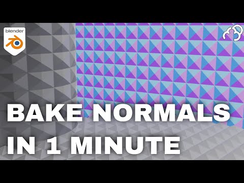

    There's always Blender...
    A one minute explanation of How To and a great visual example of what Baking Normals actually means/looks like, in case one wasn't familiar with the term and got hungry thinking Baked Normals were a new foodie dessert trend.
