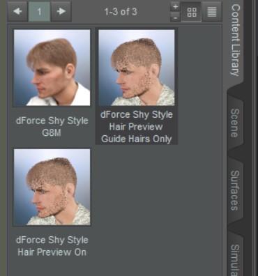

I'm sure I am not the only one who suffers from this but I might be someone who finds it more frustrating than most. I have several hair products that I would use often if only they didn't kill the viewport movement flow almost stone dead. Try to bend an arm, for example, and my viewport takes a few seconds to react and the movement is so slow. I believe this is due to fibre hair but some vendors who make such hair products seem to have overcome the problem to an acceptable degree. For example, RedzStudio hair is useable and there's even a special feature with some of their hair just to show "Guide Hairs" in the viewport. Conversely, I would love to use the Curly Bun hair more but it is probably the worst offender for killing my viewport. I just can't work with it.
