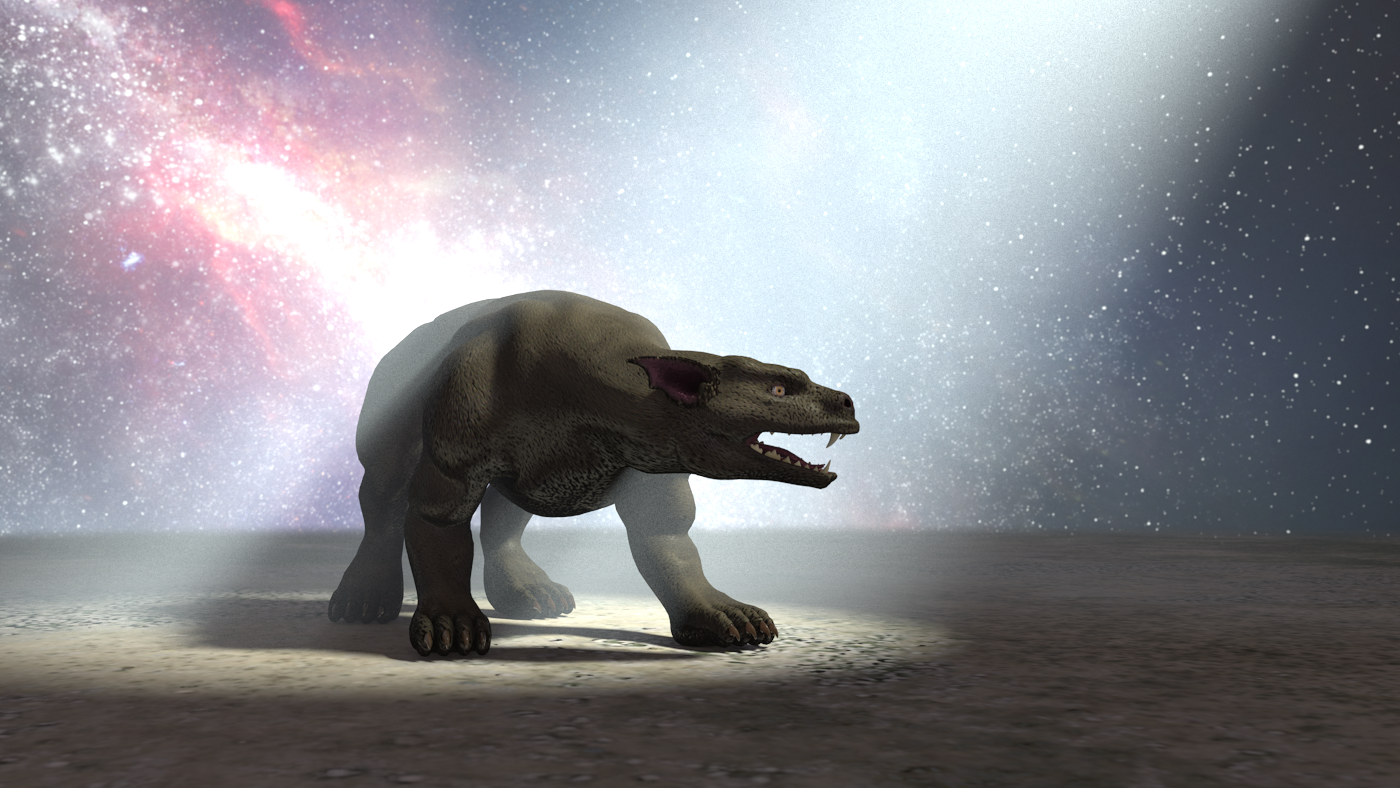

    I made a volumetric shader incase someone needs one. I dare say it works better than the UberVolume or the AoA EZ camera in certain scenarios (less artifacts)cheeky. Just download it into your My DAZ3D Library/presets/shaders or wherever you keep your stuff. It is supposed to be applied to a mesh that will work as the volume. It will inherit the color of the light(s), by default.
    Here is how to use it:
    1. Load/Select/Create an object (primitive cube, sphere, whatever).
    2. Select it + its surface(s) and apply the shader. It will turn invisible in the viewport. (Set opacity color to anything but black if you want to see the volume object while setting things up AND don't forget to reset it to black prior to rendering.)
    3. Lights can be placed inside the volume, however cameras must always be outside!!
    4. I recommend using a physically correct fall off for the lights. (With standard DS point- and spotlights set falloff to 2 and add zeroes to light intensity scale).
    5. Establish the light intensities you want to use in the scene first, then adjust the volume density accordingly. Note, use very small values, generally.
    6. You don't want to use diffuse, ambience or specular unless you set opacity color to a non-black color. You CAN carefully adjust the opacity density (avoid negative values unless you're into NPR:)), if opacity density is set to anything but 0 you can use the scatter color to affect the appearance.
    7. Enjoy!
    A tip - progressive rendering will be much faster but will also produce more noise. I recommend setting things up using progressive and turning it off for the final render.
    Yes the shader also works with emissive surfaces;)

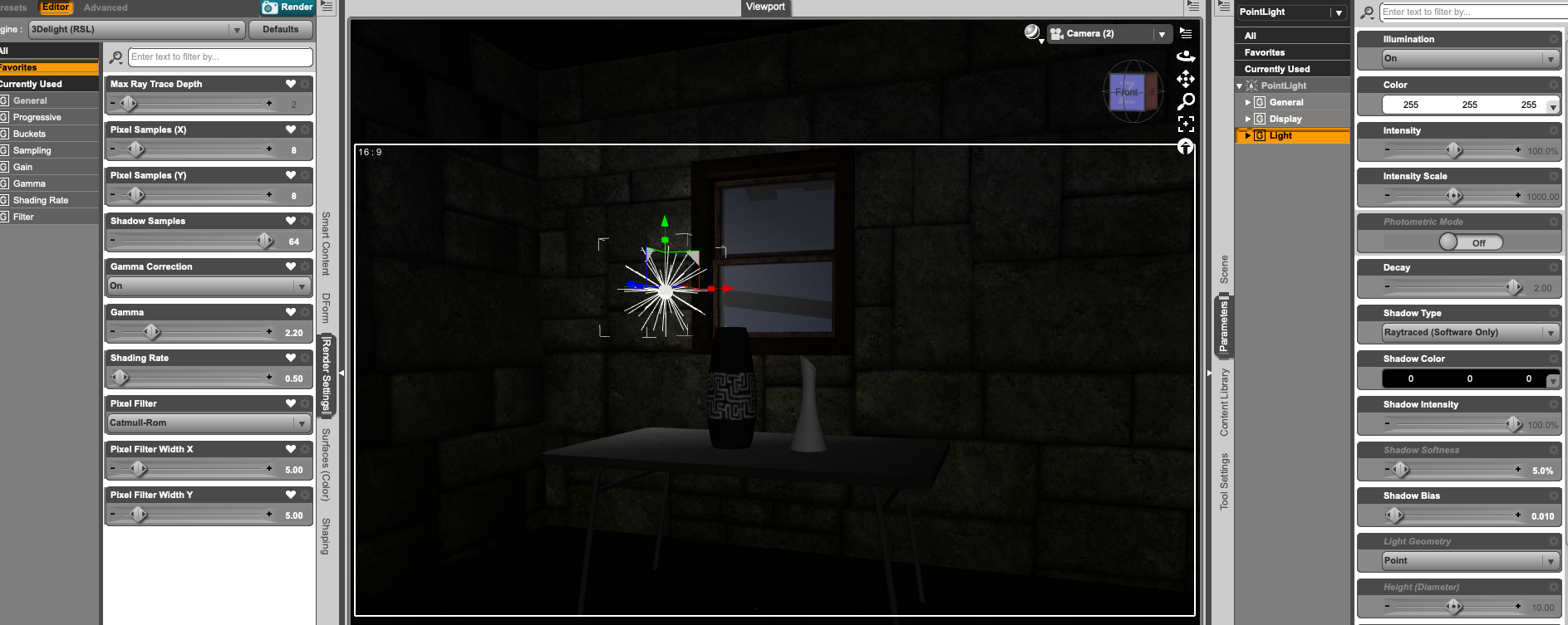

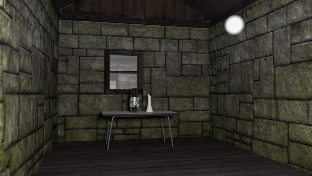

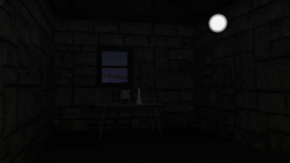

    Sven and others, maybe you can point me in the right direction, I need even light pretty much everywhere with no glossiness and no shadows and I am working in 3delight.  I have been experimenting but I am not really good at lighting at this point so I could use some help.  Thank you.
    Post edited by RiverMissy on

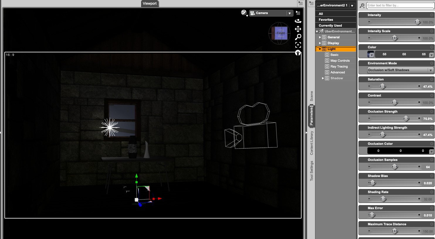

    Use UberEnvironment2 with ambient (no raytracing) lighting mode. Will flood your scene with even ambient diffuse light from all directions..
    Or use the AoA Ambient light with "diffuse only", that would add some more options to play with. (Flag surfaces to ignore it, for example)
    Thank you.  I was playing with UberEnvironment2, so this will help.

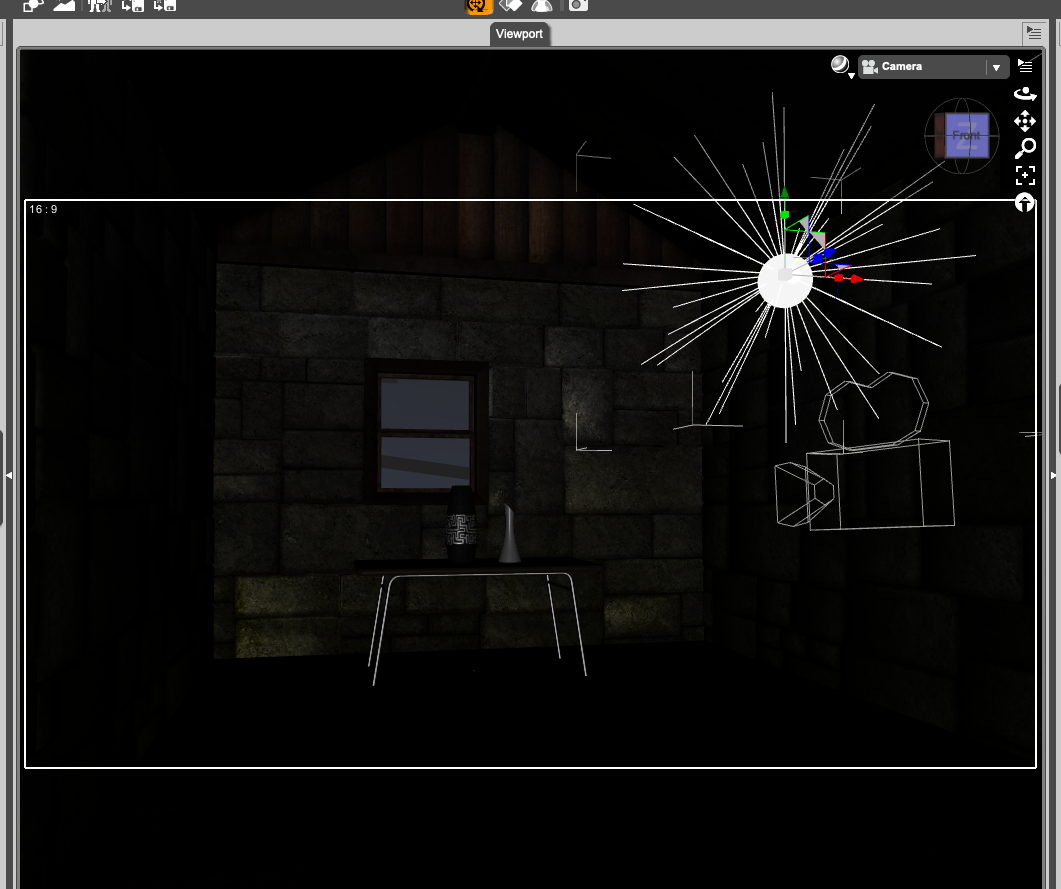

    oooohh @SvenDullah !! do you have any suggests for neutral lighting?for 3DL ?
    Post edited by carrie58 on
    Please elaborate:)
  • carrie58carrie58 Posts: 4,133
    Sven Dullah said:
    Please elaborate:)
    lighting that will evenly light my figure  very little shadows .......
  • carrie58 said:
    Sven Dullah said:
    Please elaborate:)
    Ok, and this suggestion I made for RiverMissy does not work for you? Might want to add a directional light (spotlight, distant light) and tone down the UE2 a tad? Or do you want something more "artistic"?

    Just a reminder, folks...you can use negative light intensity both for directional lights and emissives. So if you need an object that sucks light like a black hole, here is how to do it:)
    Of course you don't have to use the UE2 for it to work. I just wanted to test it with UE bouncelight;) And yeah the bounce color gets inverted, confirmedlaugh

    A bit more on the matter of light decay:
    I created a simple scene using UE2 and a standard DS pointlight. I only added raytraced shadows and some shadow softness because I hate sharp shadows;) And I parented a sphere to the light with "cast shadows" off and only ambient enabled, so we can see the light position.
    ...and the UE2 settings I used here:
    Rendered with two cameras:
    Light intensities work and the objects are "properly" lit. Now I just move the pointlight 4 meters away:
    Rendered out:
    Now I change the pointlight intensity scale from 1000 to 100000:
    I'll use this scene to test some volumetrics later, meanwhile here is a test using my volumetric shader with a DS spotlight in DS 4.20:
