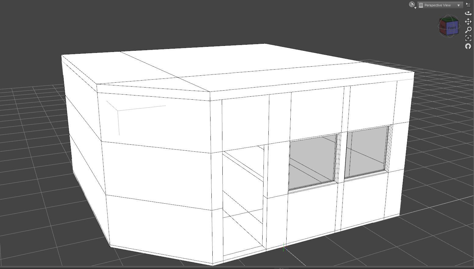

The image below shows my geometry in Blender (left) and the same geometry after beind imported in Daz (right). I've used "Collada" to export/import, but if I use "OBJ" the same problem happens (in a smaller scale, but happens). Is there a way to avoid this, or is it a limitation in Daz? These changes in geometry cause all sorts of problems when applying textures in Daz. Yes, I could UV the geometry in Blender, but I don't see a reason for it to behave like this, even with simple cubes. Apparently Daz loves its triangles...

    I think your export settings from Blender are asking for the msh to be triangulated. It's under Geometry in the export dialogue, though it is off by default

    It was "on" indeed, but things got worse when I turned it off. :-) I'm attaching two examples with three views: the first one in Blender, the second one imported in Daz after exporting from blender with the "triangulate" off, the third imported after exporting with "triangulate" on. I've tried to find a similar optin within Daz (triangulate when importing), but couldn't. Even the simpler objects were changed in some way.
    As a test, I've reimported the exported files in Blender. The one with "trinagulate" on was lightly changed (not like in Daz), the one with "triangulate" off was unchanged (the geometry was exactly the same I had originally).
    Any ideas?

    That is because you have polygons with indents, which tend to get bridged - you need to break those big polygons with cut outs, left by Boolean operations I suspect, into convex quads (not a chevron shape) or triangles to avoid the issue. Everything is broken down into triangles for rendering, and in cases where there is a bit taken out that can mean the triangle is actually briding the oepning as in your images.
