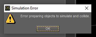

    Try to simulate and now I get:
    Checking the log, I see:
    2022-06-15 15:15:35.056 [WARNING] :: ..\..\..\src\dzdynamicsimobjects.cpp(1581): No Edges are Simulated!
    2022-06-15 15:15:35.104 [INFO] :: Total Simulation Time: 1.54 seconds
    Speaking as a Technical Writer, DAZ really needs to hire one to document this stuff. Not just dump Software Engineer code into an HTML page and say "here you go!"

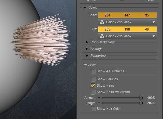

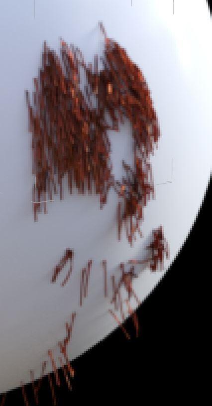

    This is what I found.
    You can apply the dForce property to the hair surface, after you have turned on "Preview PR Hairs." (I assume "PR" stands for Post Render?)
    You can then do a dForce simulation but some hair will fall out (depending on the parent mesh) like a middle aged man.
    Still no idea how to change the actual length of the hairs, as the "Length" value seems to only apply to the preview window.
