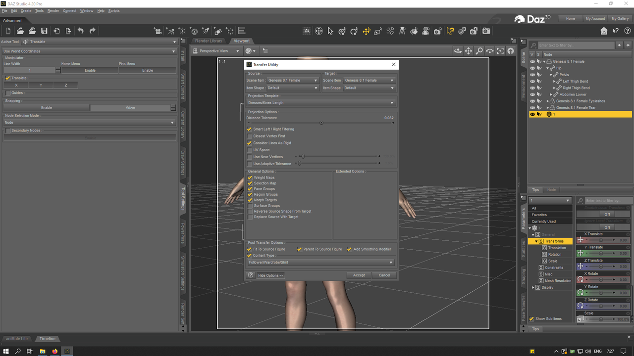

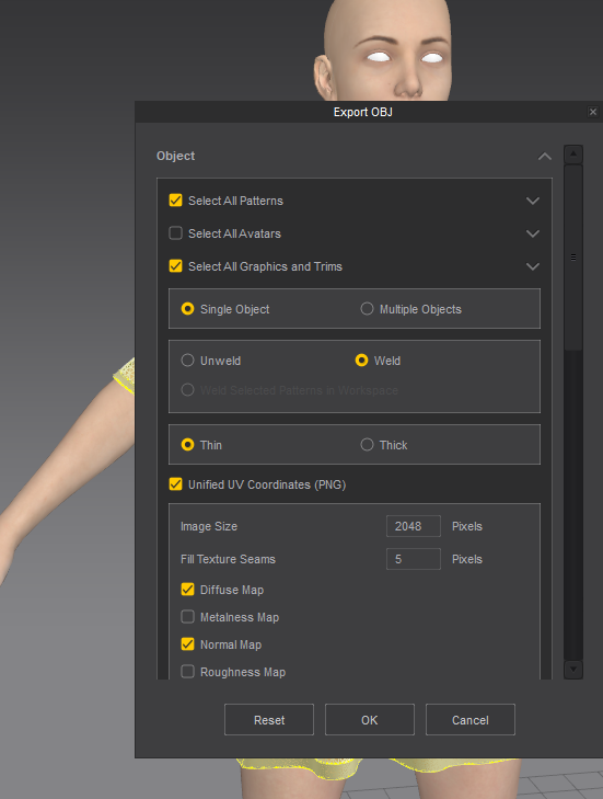

I wanted to make my first t-shirt and after transferring in Daz 3D I have this problem, please help me
Settings Transfer Utility
Export settings marvelous
  • Richard HaseltineRichard Haseltine Posts: 109,626
    The problem is that the weight-projection goes by what is nearest, and with the loose sleeves that jumps abrouptly from the torso to the shoulder, completely missing the collar bone, so there is nasty stretching. The fixes are
    • use dForce and don't even try to rig it
    • edit the weight maps to even out the effect
    • add morphs that are triggered by the bends to smooth the results (JCMs)
    • a mixture of JCMs and weight editing.
    Unfortunately the looser the fit, the harder it is to rig (hence the number of corsetted dresses).
