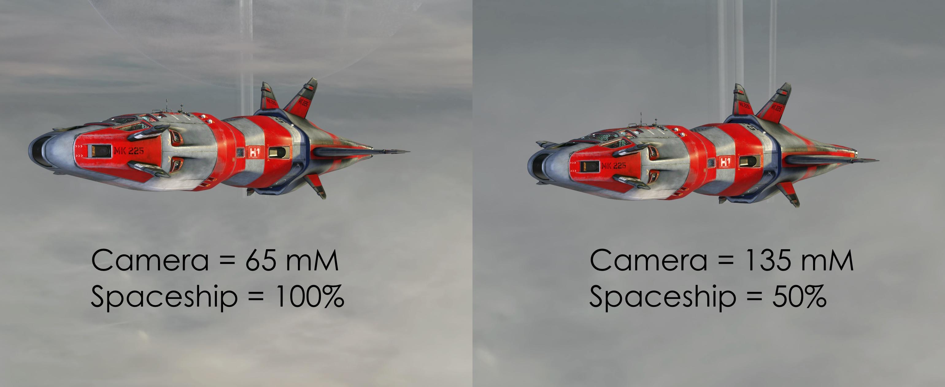

    I thought I would illustrate it by using https://www.daz3d.com/the-phantom and a HDRI, https://www.daz3d.com/orestes-iray-hdri-skydomes--oblivion, with a vertical edge on saturn-like planet.  I rendered with two settings, camera 65 mM focal length and the ship at 100% and 130 mM focal length and the modal at 50% of normal size. Note the thickness of the ring bands:
    3080 x 1261 - 477K

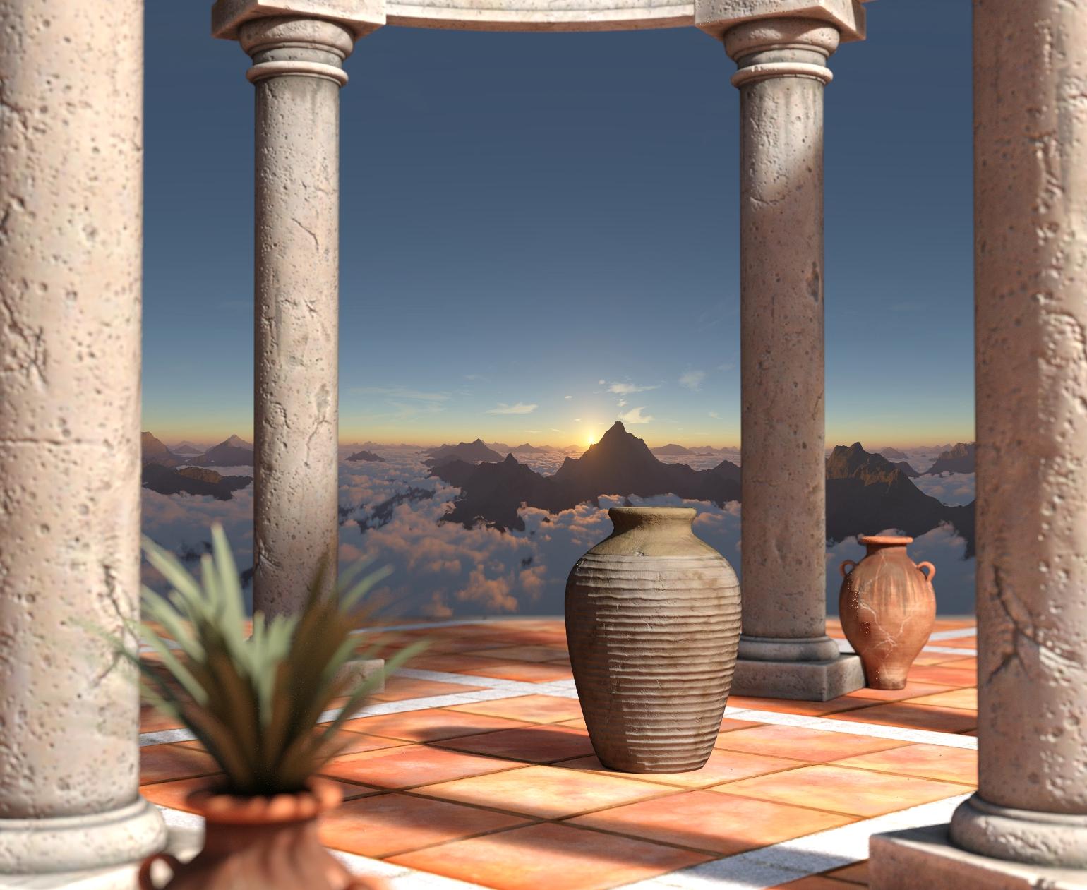

    It does but the effect is probably more subtle than the writer wanted.  I did want to show something I threw together. I have sentimental fondness of a product called Top of the World  which looks like this
    So i did a quick iray conversion (discarded lights and skydome, RSSY 3dl to Iray converter, and dropped the skydome texture into the render environment  backdrop, and added an hdri to light the scene):
    1540 x 1261 - 1M
