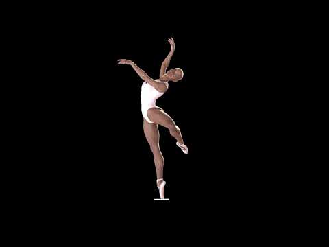

    Thank you. I got animate2 but still trying to figure it out too. I will try baking the animation back into the timeline to get it to animate each keyframe and see if my edits stay or get changed again- so far I have this. It isn't smooth yet-like at all, but towards the end where the foot dips is where I want to fix it and not have Daz 'fix' it back. This is pre-aniblock/animate2 fixes will edit after to see if I could get it to work.
    https://youtube.com/shorts/wNkVdAM-5pk?feature=share

  • benniewoodellbenniewoodell Posts: 2,000
    Hmm, looking at what you're doing, you could try going to the halfway point between the two keys and pose the foot with with the toe flexed to be on the ground, or the toe touching the ground as much as it can, that might work better than keying everything and going that route. It would force the interpolation to at least go in that motion and it might not dip under the ground plane. It's definitely a good start!
  • sunnyjeisunnyjei Posts: 502
    I took your idea of making a keyframe for each edit in the hopes Daz wouldn't change it. It looks like that works as long as I don't add more frames at the end with another pose- then Daz went back and made changes. So my next attempt will be to create aniblocks of pose 1 to pose 2 then another block of pose 2 to pose 3 and build from there and hope Daz doesn't change it too much- or maybe just render out the poses that work and put them all together at the end in Davinci. Thanks for all the help! Slightly better edit :)
