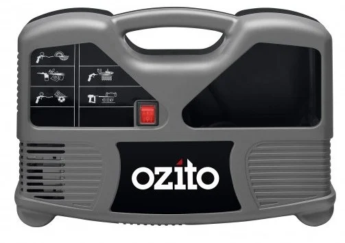

    You can't beat a proper air compressor
    Been waiting for the temperatures to get up outside, so that I can cover the neighborhood in a dust cloudblush

    An issue with using an air compressor is that they always build up moisture / water inside the tank, and that could cause problems down the line.
    That said, I'd think in an AC environment with the PC warming up the moisture would be gone quick, but I'd rather be safe than sorry.
    I use a vacuum along with the compressed air, the vacuum nozzle mostly just near to suck in the dust blown free from the air duster, and externally I'll use the vacuum nozzle for fans and back of the video card for a push/pull with the duster.

    If I was using a compressor I'd want a moisture trap on it.
