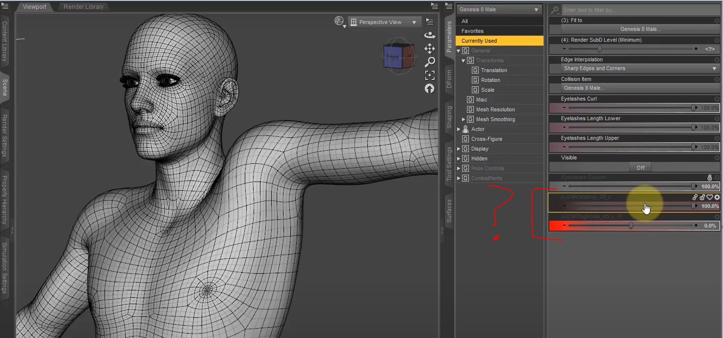

Got some questions though if anyone can answer it.  In the first picture.  If I had a morph for each of the leg lift.  Will it combine both morphs if both legs were lifted would it just cause it to balloon up?
Likewise with the arm lift and bend in.  If I had a lift arm morph and an arm bend morph and pose the arm to be lifted and bend in will they get combined and balloon up or DAZ knows to blend the two morph in between.

    Think this video will answer your questions. As far as I can see, no. These types of morphs are named to come into play only when their counterpart in the figure does. [n.b. the product being sold includes poses, not morphs]
    Post edited by Catherine3678ab on

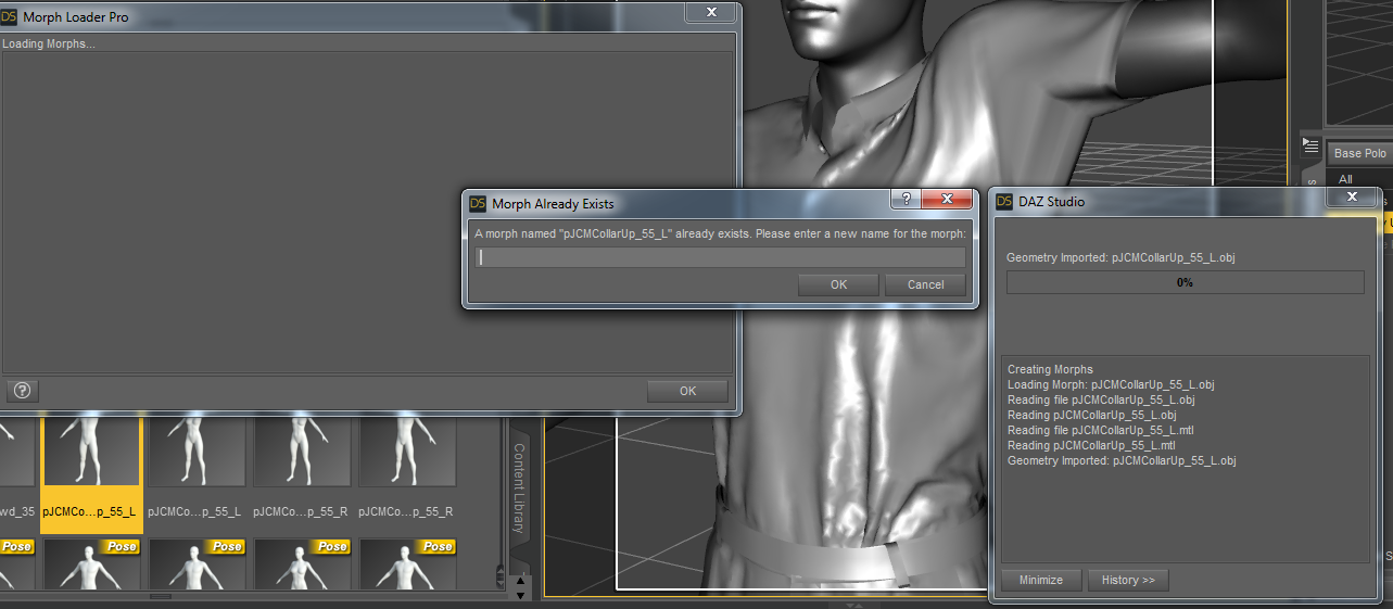

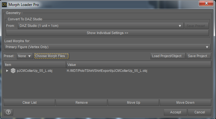

    I am not familar with DAZ's UI.  I am not seeing the extra pJCM in the parameters is it a hidden thing?
    I did some testing and it is not working.  I created a morph for pJCMCollarUp_55_L and named the morph OBJ as pJCMCollarUp_55_L as stated in the video.  I loaded the OBJ morph into Morph Loader Pro and left everything as defaulted.
    DED used a preset, not sure what it does or if it is required as I do not have a preset.  The preset was also left as none.  I then click accept and a pop up appears because of the duplicate name, but in his video he did not get that.  I then just left the row blank and clicked OK and get a message that morph is successful created, but I do not see the morph take into effect.  It's still messed up underneath the armpit.

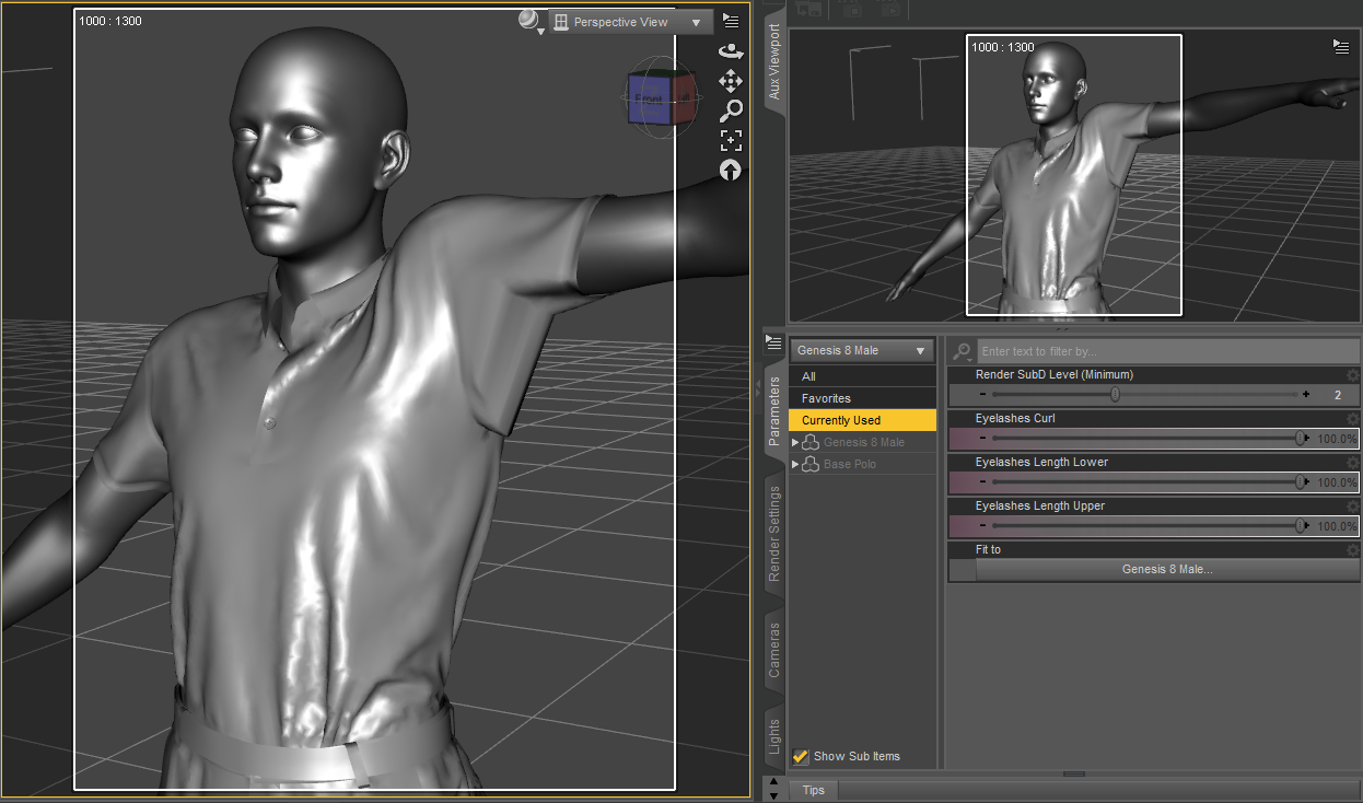

    Yup, I was missing some extra steps.  His YT vid didn't have the extra steps.  It was in the mp4 per the install.

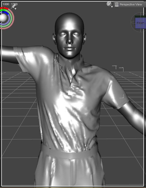

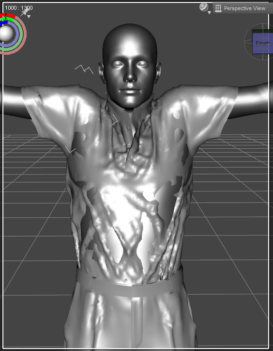

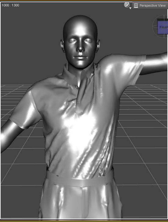

    I got it working now, however, the results weren't what I expected and now my worrisome question has been answered from my first post.  Since I'm using MD to sim the shirt for the morphs when I apply them to specfic arm/leg pose, it does affect the entire OUTFIT if both poses are used at the same time.  Might have to return it now :(
    Guess Im back to square zero again.

    I tried and you can't change the Name in "Parameter settings".

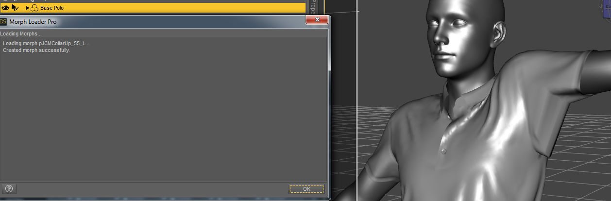

    I redid my morph from scratch with the right name.
    The transfer into Morph Loader Pro is successful.
    But I don't see where he is?
    When I put the pose on my character, the polo shirt does not run.
    I don't see it anywhere.
    I thought it was the quality of my import.. I redid it to be independent (my .obj with another name) and this time it appears and I have the little cursor and everything works very well in the slider...But it is not automatic...
    I think I have a particular concern. Maybe using Morph loader pro? I'm stuck. Do you have an idea?

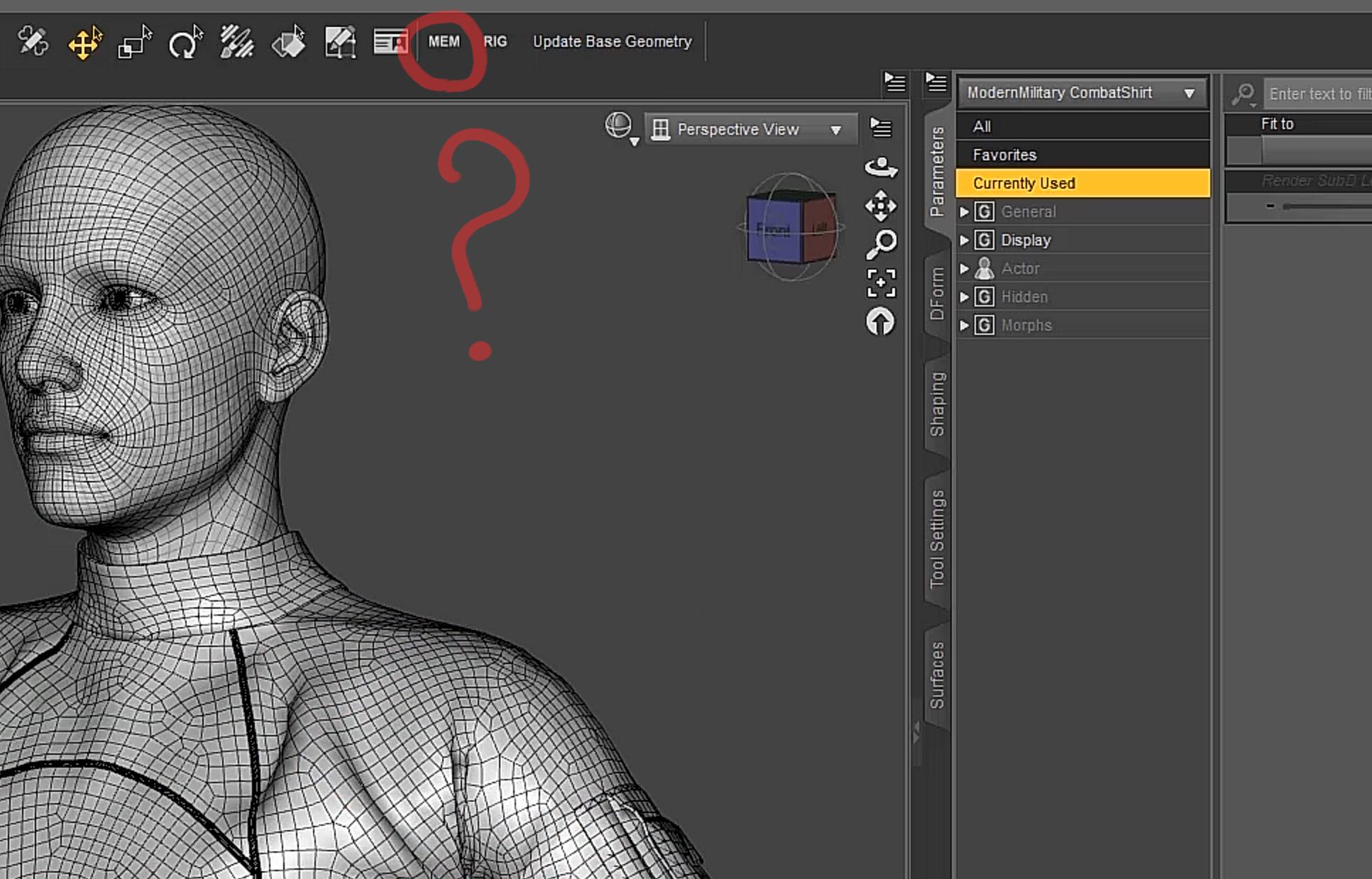

  • Eternal ForceEternal Force Posts: 307
    edited May 2022

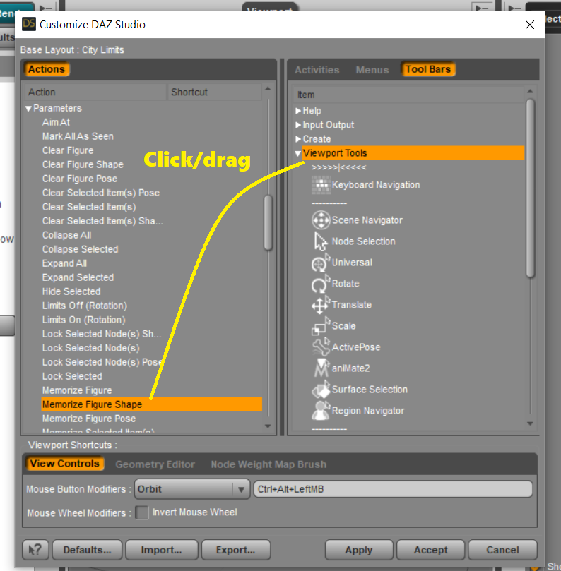

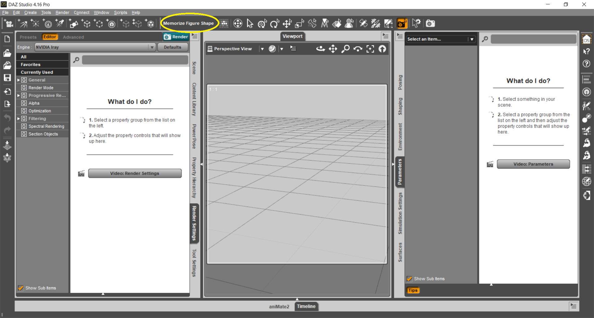

    Hello guys,
    I am following the tutorial of DarkEdgeDesign. It is very interesting but I am having some trouble. After DarkEdgeDesign has created a pJCM, he zeroes the figure, selects the clothing and memorizes it. This is where my problem is. In order to memorize the pJCM DarkEdgeDesign clicks the "MEM" button on his screen. Please have a look at the attached picture. I don't have this button. I tried to customize my interface but I could not find this button despite the fact that my version of DAZ Studio is newer than his. How do you memorize a pJCM? Where this "MEM" comand is located in the DS interface?
    After pressing "MEM" button, DarkEdgeDesign "goes ahead and saves it to his Library. How is it done? Just "Save as"/ "Support Asset"/ "Figure/Prop Asset"?
    The devil is in the details. Can you help me?
    1933 x 1239 - 771K

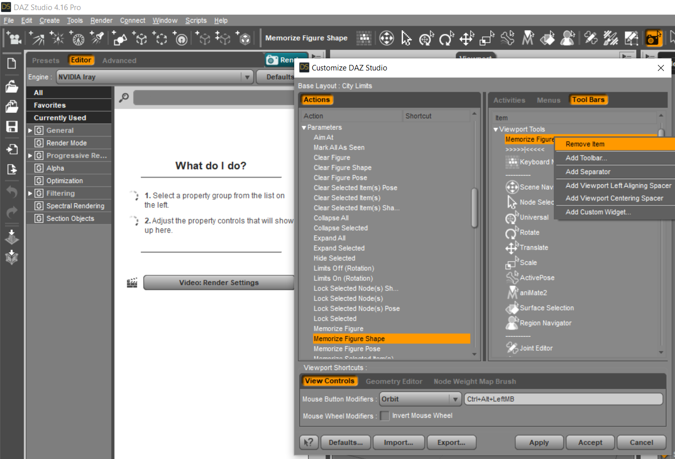

    edited May 2022

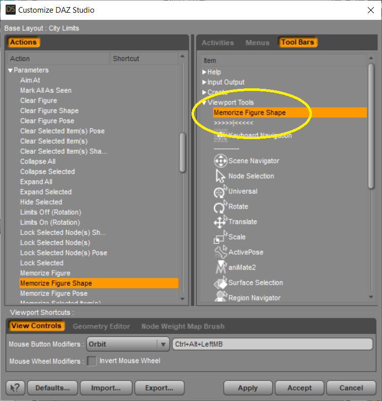

    Using:  Window/Workspace/Customize in D/S we can add any number of extra commands to click on, to the toolbar of choice.
    The Memorize Commands can be found at:
    Edit > Figure > Memorize
    Parameters Tab > hamburger menu > Memorize
    Shaping Tab > hamburger menu > Memorize
    794 x 809 - 147K
    752 x 790 - 153K
    1920 x 1030 - 345K
    1342 x 912 - 304K
    pJCMs are saved as Morph Assets. I tend to put mine in a folder called pJCMs.
    Thank you very much, Catherine! smiley   You are a lifesaver!!! cheeky   I am going back to creating my pJCMs. Hope, everything will work this time!
