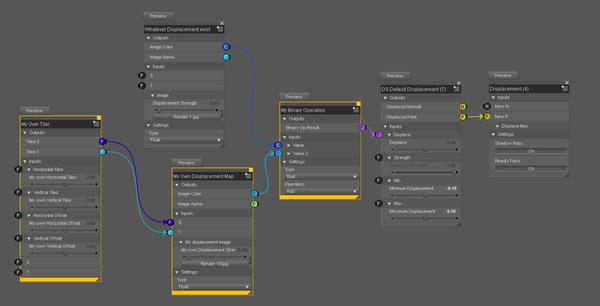

  • Takeo.KenseiTakeo.Kensei Posts: 1,303
    Of course you can. Whatever the complexity of the actual network, you can add displacement on top of what exist
    Locate the DS Default Displacement Node
    Then you add a Binary node configured to Add Floats
    Before that one you add an image map node and eventually a tiler and make connections to one of the input of the binary node
    Redirect whatever displacement exist to one of the other input of the Binary node
    Example below. In yellow are the additionnal nodes

  • WendyLuvsCatzWendyLuvsCatz Posts: 40,531
    Displacement is different in carrara to DS it kinda depends on how you got the model in as to how it applies.
    DS has negative displace Carrara like Poser does not.
    Most stuff needs tweaking.
    The usual trick is to use an add operator and have the map and a value slider, duf imports tend to come in this way to C8.5 you need to manually do it on C8.1.
    You may need to enable subdivision.
    Dispacing in 3D view should show you the result as well as the interactive update in the preview.

    Very nice and thanks for taking the effort to help. Just one problem how do I control the additional min and max of the additional Displacement
    Wendy thanks I didn't know about Carrara being like Poser and yes I had Subdivision selected. I know about Poser displacement and how to set that up so it shouldn't be hard to do that, cheers. If the Shader Mixer route becomes to much for me I will give this another try.
    Don"t you already have a min and max ? Or do you mean you want a separate control?

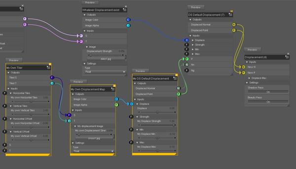

  • SzarkSzark Posts: 10,634
    Yes I have a min and max for the procedural rock displacement but I need a separate one for the displacement map
    edited January 2015
    Then forget the binary node and try this one
    1287 x 737 - 97K

  • Richard HaseltineRichard Haseltine Posts: 109,302
    Unless something has changed, using the strength slider on the map to control displacement strength won't work - as far as the calculations are concerned that's pulling the values down (white, instead of 1, is 1 * strength) which means that the displacement will remain full at the minimum but will not attain the maximum. The map strength for displacement should always be 100%, you should use a separate value parameter to control the displacement strength.
    well in this case 100% will be ok so I can't see it being a problem but thanks Richard I had no idea that this was the case.
    I gave it a shot and I got all the channels sorted and renamed, applied, loaded the displacement maps and to result was no displacement at all from either the maps or the procedural side. I will have to leave this image for time being and finish to others. When I get time I will have to come back to this and play some more. That the trouble with having a deadline. :(
    I appreciate all the help though and it would be nice to see if it is indeed possible, :)
