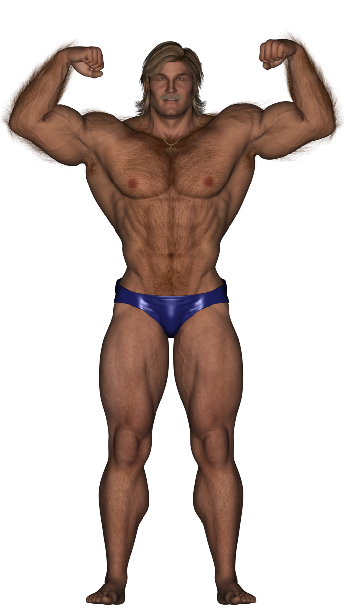

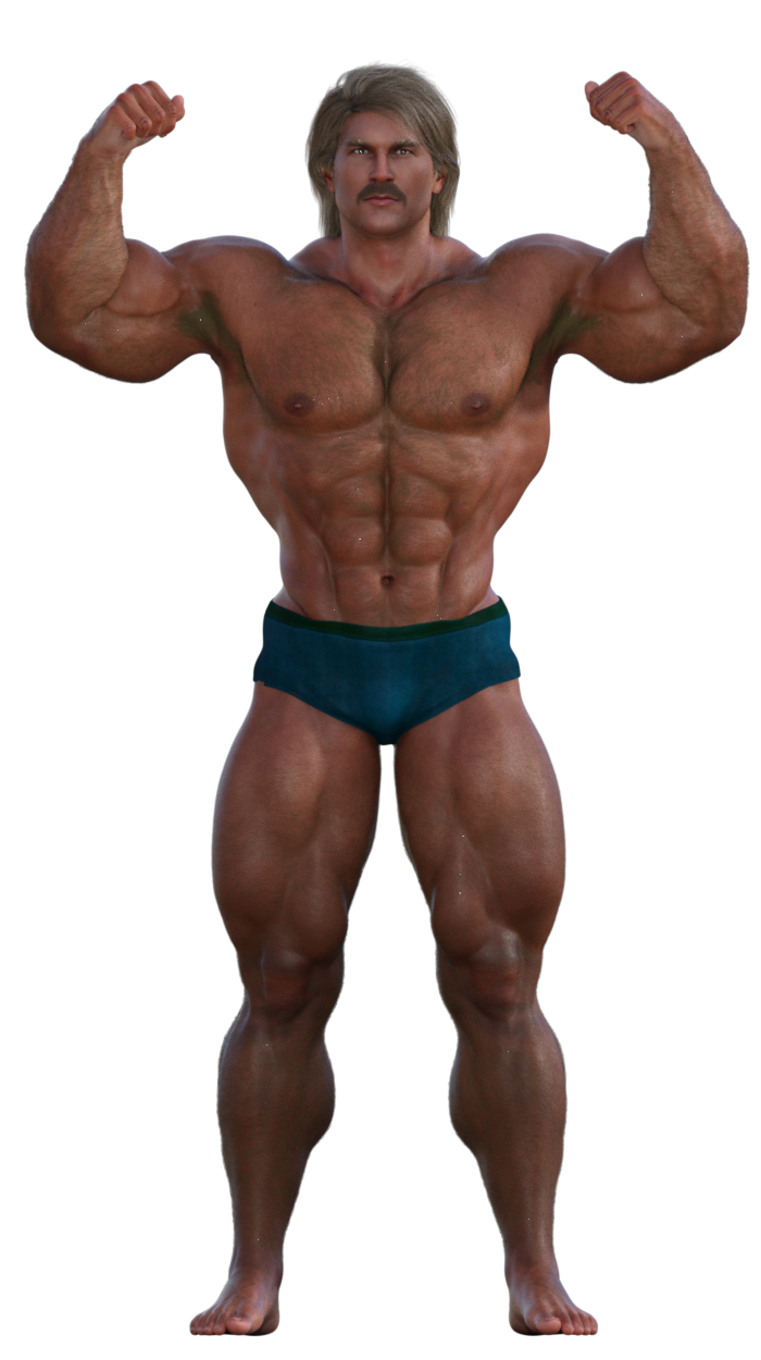

G2 and earlier renders really quickly in 3Delight. But I tried rendering one G3M character in 3Delight and after 3 hours of rendering, all I saw was one eye and part of the forehead. With Iray, the entire image was done in less than ten minutes.

    The first character is G2M and rendered in 3Delight in a few short minutes. The second character is G3M and after 3 hours of rendering in 3Delight, I saw ONE eyeball and part of the forehead. But in Iray he rendered in about ten minutes as you see in the image. I had no lighting or background. I went with the defaults.
    700 x 1250 - 551K
    700 x 1250 - 594K
