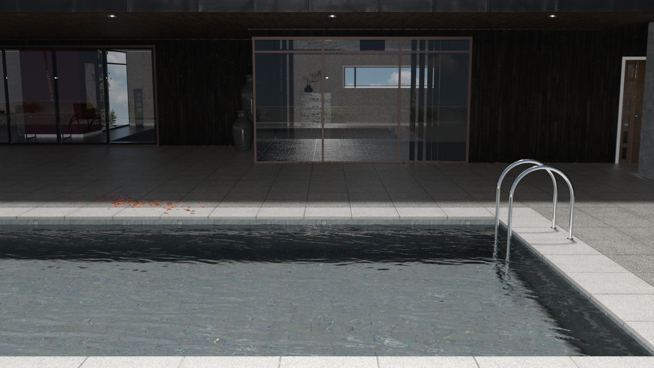

Has the new version of the water turned black?
I set the Abbe, base color, Refraction Weight, and Transmitted Color to no avail. The thin wall is turned on and there is no refraction effect.

    I found the product link, the color of the official picture above is correct, or rather transparent.
    https://www.daz3d.com/the-pool-house ;
    I added an HDRI and rendered a picture without any parameter modification, and there is still that difference.
    1500 x 782 - 387K
    453 x 603 - 74K
    1920 x 1080 - 3M
  • barbultbarbult Posts: 26,380
    Everything in your render is much darker than the promo image, not just the water. Everything in your render seems to be in shadow. You can't just an load an arbitrary HDRI, with an arbitrary amount of light coming from an arbitrary angle, and expect to reproduce promo image lighting. Experiment with other lighting, maybe sun-sky at noon.

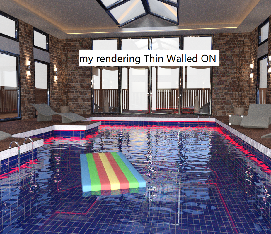

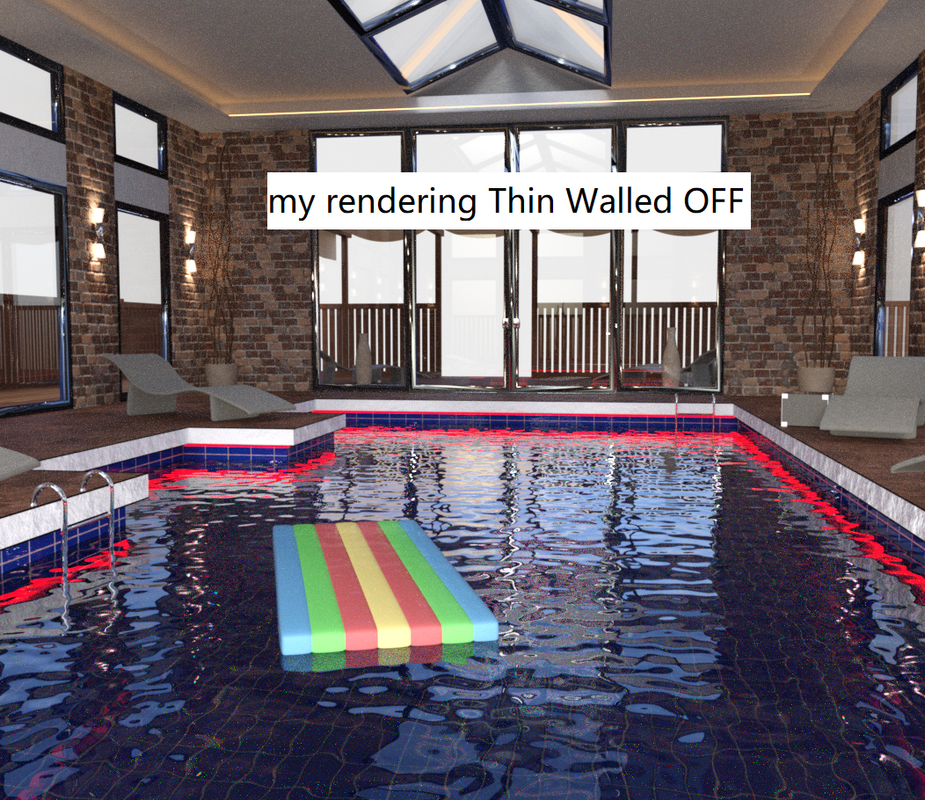

  • This effect can also be seen on other assets. Through the comparison of the membrane switch, we can see that the water has indeed turned black.
    Here are the official pictures:
    Here is my rendering:
    1052 x 910 - 2M
    1052 x 910 - 2M
    you're right.
    I used ambient lighting where the sun was overhead, and it seemed that was indeed the reason for the lights. Ha halaugh
    I took a closer look at another scene, as if it was because of the sunlight.
  • PadonePadone Posts: 4,036
    @opppoe As @barbult says, water is a reflective surface, so it reflects what you have in the scene, including the sky. A dark sky will get a dark water. As for thin walled it turns off refraction, that's the bending of lights through the media, thus the deformation you see for the underlying surface.
    Yes, that's right
