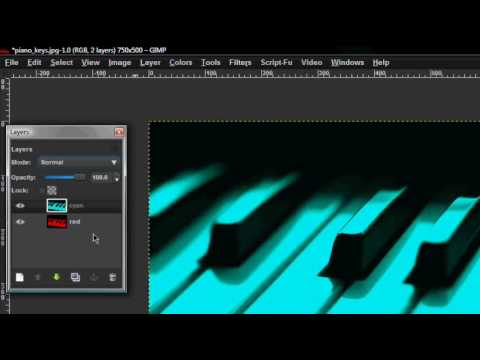

  • Try loading the jpg render into Gimp which is free and use the filters in that?

    Try dithering in GIMP to 16 colors.
