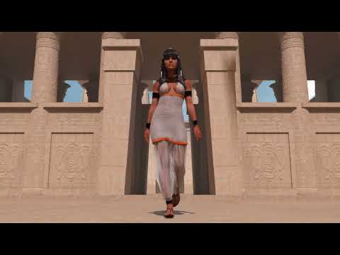

I am attempting to use just the Dress portion of the outfit, but the lower skirt part just sticks to the models legs instead of flowing and blowing around in the wind (I have tried with and without wind node, moving wind node, changing velocity of wind node to create turbulence, etc). Even with the wind node off, the dress conforms and sticks to the legs as if there's a major amount of static cling. I've attempted to mess with the surface of the object, reducing friction, shear strength, GSM, etc and nothing seems to prevent the static cling effect. Does anyone else have any thoughts on how to correct it?
Here's a short clip of the behavior I am talking about:

Thanks, the part in question definitely has dForce, when I move the fan around the surfaces change, but then they stay static until the wind changes again. I will have a look at the weight mapping of the skirt, though, I didn't think weight would cause a static-cling-like effect.
@hansolocambo do you know where the weight map file is located (or if there is one)? When doing the brush inside of DAZ, there are a lot of places that are bright red that will not dim, go to blue, or fully erase from using the brush (alt+paint). I think it would be much better to map it in another program if possible, so I can start over from scratch and only add weight where it's necessary. Thoughts?
