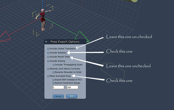

  • FenricFenric Posts: 351
    You should be able to do what you want...

  • Steve KSteve K Posts: 3,446
    Thanks for the prompt response. Yes, that would be correct if that menu showed up. The reason it does not is probably because I am using the wrong product, "Pose Helper for Carrara". :ohh:

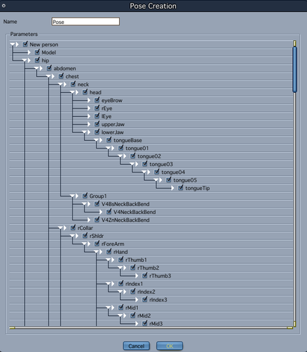

    Pick the root of the figure, go to the NLA tab, click "Load Clip Data", pick the pose clip from the dialog -> the clip is turned into proper keyframes. Then delete the NLA clip from the track.
    Here's what I did:

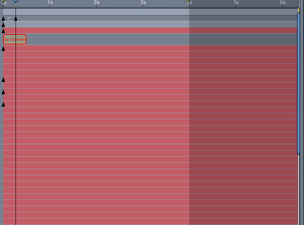

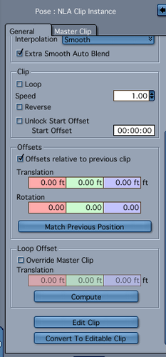

    Make sure your clip is in the sequencer and the play head is located over it. Select the Pose Clip and choose, Convert To Editable Clip. After that is done and Carrara gets done thinking about it, you should now see an Edit Clip button. Press it and the clip should turn red. You can now edit the morphs. When you are done, click the Finished Editing Clip button.
    I tried this with shape morphs and expression morphs and it worked.
    I don't know if you looked at the window with the figure hierarchy that opened when you chose to create a pose clip, but if you expand it, it shows the complete rigged figure with checkboxes next to the various trees. If you deselect the checkboxes for any of the trees, you can move the limbs that were left unchecked when you created the clip. I wanted to see if morphs behaved in this manner as well. They don't- sort of.
    I used a morph on the left and right eye to slit the pupils. I also made the ears pointy. I created the clip and un-checked the left eye. After the clip was created, but not in the timeline, I zeroed the figure which got rid of the morphs I had applied and the pose. I then put the clip in the sequencer and the left eye retained the normal pupil shape and right eye had the slit pupil. I could rotate the left eye using the rotation tool, but not the morph slider.
    When I went into edit mode, I could do whatever I wished. If I had advanced along the timeline it created a keyframe within the clip.
