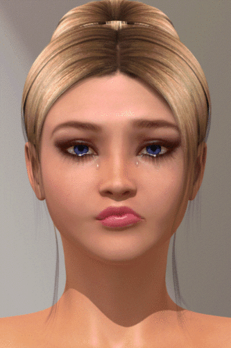

  • JonstarkJonstark Posts: 2,738
    Strange world we live in, I was working on something similar recently. I was experimenting with odnajdy's Tears product from Rendo, which actually takes and morphs V4's existing tear mesh. In my case I ended up setting the highlight to 65.10% and shininess to 12.87%
    What you need to know is that in the texture room the channels of shininess and highlight control the specular effect. Highlight controls how bright the spec is, and Shininess controls how wide or narrow the spec 'spreads'.
    Since you're dealing with a spec map, unless I misread that, I would put the spec map in the highlight channel using an operator: multiply, with the texture map in the first channel and a 1-100% in the second channel and just bring that percentage up til it worked right, and then set the shininess channel with something similar to the 12.87% I used. It's a matter of adjusting to suit what you need til it looks right.
    400 x 600 - 125K
