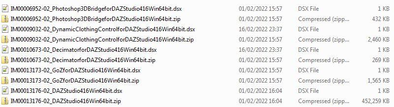

    ETA: these are the files I'm aware of that you need to backup:
    You may not have the DynamicClothingControl not the Decimator if you've never owned those products.
    NB: This assumes it's the General Release you want to save the installers for - the Beta filenames are similar but say "PublicBuild" in their filenames. ETA: And the main software installer for the Beta starts IM00012000 not 13176.
    If you then install the latest version and decide you want to go back, then for DIM you can simply copy those backed up installers back to where you found them and run DIM to reinstall the older version. I'm sorry but I really don't know how/whether you can do that in Daz Central.
